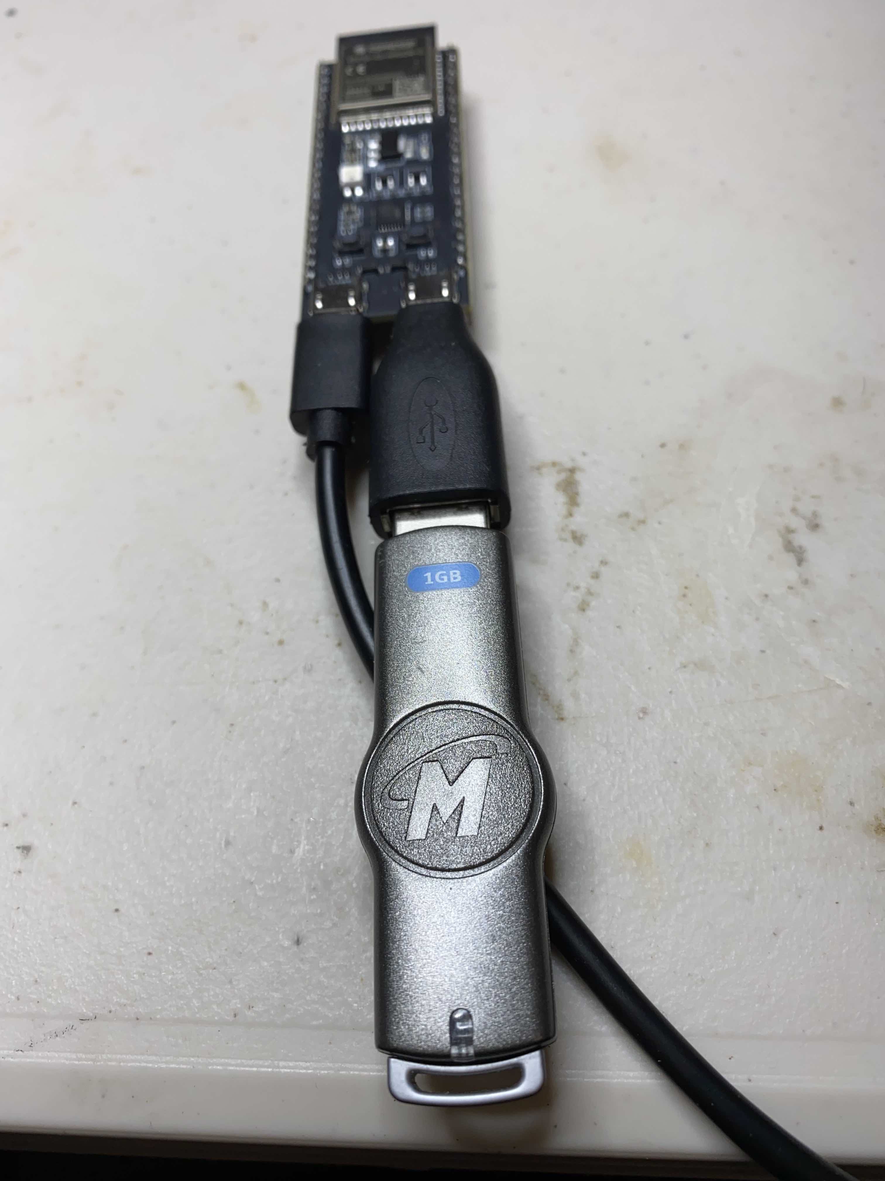

akmishra99
- Posts: 10
- Joined: Sat Mar 07, 2020 5:48 pm
Re: Example "msc": crash HUB: Short device descriptor transfer failed
I am using esp-idf 5.1 in (espressif/idf container) , I am able to successfully build and flash, when I connect usb pen/stick drive as shown in photo (msc_forum_pic1.jpg) I keep getting "I (953) example: Waiting for USB stick to be connected" Please see detailed log below), I have checked with multimeter that usb host port has approximately 5v on Vcc, also checked that USB pen drive has FAT16 formatted disk, in idf.py menuconfig I have enabled tiny USB stack and USB on the go (USB-OTG).
what I need to do to get it working properly, I am using examples (
esp5.0/project/peripherals/usb/host/msc/main/msc_example_main.c)
-Thanks
-Alok
-Thanks
-Alok
- msc_forum_pic1.jpg (427.91 KiB) Viewed 6480 times
