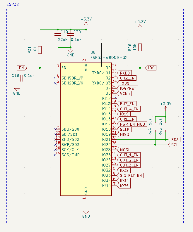

After developing a custom hw baord using the ESP-WROOM-32D module in VScode (using arduino) for a couple of weeks as a part of a student exam project, i was going to run some unit tests using platformIO. After creating a simple test in the testfolder and uploading it and running it the terminal spitted out a crash-dump, i thought there was something wrong with my tests and tried to upload my program again from platformIO, the same crash-dump is spitted out over and over again on the terminal. I can upload my program ok, but all i get is a crash-dump on the terminal. The HW has been working fine for several weeks and just after trying to preform a unit test the module crashed.
Any help regarding this is greatly appreciated. Seems like it should not be possible to brick a esp32 just by running unit tests on it? The same test runs fine on a esp32devkit board, but that does not have a wroom-32D module.
My best guess is that when i uploaded the tests something got corrupted, maybe the partitions or something. im using the env:esp32dev, which probably insn't really correct. I am using the SPIFFS to save a html webserver if this could interfere with the partitions in any way.
I have tried uploading "hello world" example using the idf.py and tried uploading a partition table and erasing flash etc. But whatever i've tried has not helped, the same crash message is sent to terminal when opening the monitor. Iv'e also tried uploading progams using arduino ide (just as a test) which also works to do, but result is the same.
Please see the hw hookup image aswell, i have almost all "pins" connected to the module. Maybe this could interfere? however as said before this board and hw setup worked for weeks before running the tests from pio.

Nothing jumps out wrt what could be wrong... you could try erasing the entire flash, maybe there's something left that confuses the chip?

Hello ESP_Sprite, thank you very much for your reply! :)
I tried the command you suggested (i guess it's the same that ive tried from within platform io).
Unfortunately the result is (almost) the same. I actually de-soldered the esp32 module from my pcb and replaced it, and my board is now working fine with a new module.
When soldering the faulty chip to a old (previously broken adafruit huzzah board) i can program it as before and tried erasing the chip with the suggested command, but it shows error message on this pcb as well. Is there any "holy mary super duper-type factory reset command" i can send, or how can i make sure bootloader and partition table is actually uploaded?
What could cause this behavior just by sending new software (running tests) using platformIO?

No, that's about the 'reset-est' thing you can do. Could be that your module is simply broken somehow.
