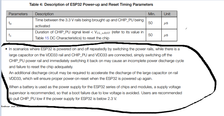

Hello Team,
We are using ESP32 Modules and chips since many years into different IoT Products which works fine without any issue so far with external supply.
Now, We have designed one product which is operating over battery and found one critical issue which is below.
When Battery goes into discharge state at that time ESP32 Module stops working but strange thing is like there is no any sorting between VCC and GND.
We didn't use the supervisor IC and our battery haven't BMS features as well, so ESP get the below 2.3 V.
After this scenario we have observed that ESP not boot up. We have also observed 3.3V on pin number 25(GPIO0) instead of 1.8V (As per wrover module design) . Let us know how to recover the ESP from this scenario.
Let me know if anyone has faced this type of issues when they have operated product with battery but without BMS support.
Also let me know if need anything else from my end.

Postby WiFive » Mon Mar 14, 2022 6:44 pm
Why should gpio0 have 1.8v?
Afaik the only way to exit stuck state is to pull en pin low until voltage is good.

WiFive
Posts: 3529
Re: Need help for Battery Support with ESP32-WROVER-I Module
Postby WiFive » Tue Mar 15, 2022 7:26 pm
Isn't wrover-i supposed to be bootstrapped to 1.8v or did you set efuse? Is it first generation wrover or B or E version?
Did you dump the flash? Did you try reprogramming? Did you check flash status registers?
Is this a different design than your other thread with boot failure?

WiFive
Posts: 3529
Re: Need help for Battery Support with ESP32-WROVER Module
Postby WiFive » Wed Mar 16, 2022 4:04 pm
ESP32-WROVER and ESP32-WROVER-I are first generation 1.8v
ESP32-WROVER-B and ESP32-WROVER-IB are second generation 3.3v
ESP32-WROVER-E and ESP32-WROVER-IE are third generation 3.3v
I don't know if running at wrong vddsdio voltage may contribute to your problems.
I think you need to wait for espressif hardware analysis that you sent them schematics and samples.

WiFive
Posts: 3529
Postby WiFive » Wed Mar 16, 2022 7:16 pm
It may work fine at wrong voltage for a while, but also may damage flash over time if it is above rated voltage. I cannot say whether it is connected to your problem but it is something to ask espressif about. Other than that I don't have any suggestion, sorry.
I don't know what idf version you are using but there was some fix to raise 1.8v regulator output in the past to solve some flashing issues.
