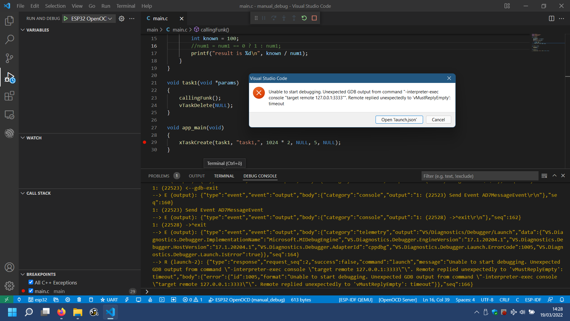

Hello! I tried to setup the Openocd debbuger on VSCode to debug a simple software working in an ESP32 (This one, that is a DOIT ESP32 https://it.aliexpress.com/item/32799253 ... 3696TdQRqC).
I'm working with ESP-IDF v4.4 on Windows 11. I use the ESP-PROG to debug (https://it.aliexpress.com/item/33048891 ... 3696s7Mwsj).
I followed the tutorials explained in the following pages: I followed the instructions and I used Zadig to install the USB driver for the ESP-PROG.
The set-up I produced is the following:

  • ESP-PROG: Pin Vjtag to ESP32: 3V3
  • ESP-PROG: Pin GND to ESP32: GND
  • ESP-PROG: Pin TMS to ESP32: G14
  • ESP-PROG: Pin TCK to ESP32: G13
  • ESP-PROG: Pin TDO to ESP32: G15
  • ESP-PROG: Pin TDI to ESP32: G12
I'm using a simple code to test the debugger, if needed I can share it. However I think the problem is something else.
1) if I try to flash the ESP32 via the UART method (WITH THE ESP-PROG CONNECTED TO IT), It fails with the message:
Uploading stub...
Running stub...Stub running...Changing baud rate to 460800Changed.
WARNING: Failed to communicate with the flash chip, read/write operations will fail. Try checking the chip connections or removing any other hardware connected to IOs.
Configuring flash size...
Warning: Could not auto-detect Flash size (FlashID=0xffffff, SizeID=0xff), defaulting to 4MB
Flash will be erased from 0x00010000 to 0x00039fff...Flash will be erased from 0x00001000 to 0x00007fff...
Compressed 169568 bytes to 89379...
A fatal error occurred: Packet content transfer stopped (received 8 bytes)
The terminal process "c:\esp\tools\python_env\idf4.4_py3.8_env\Scripts\python.exe 'c:\esp\esp-idf\components\esptool_py\esptool\esptool.py', '-p', 'COM3', '-b', '460800', '--before', 'default_reset', '--after', 'hard_reset', '--chip', 'esp32', 'write_flash', '--flash_mode', 'dio', '--flash_freq', '40m', '--flash_size', 'detect', '0x10000', 'manual_debug.bin', '0x1000', 'bootloader/bootloader.bin', '0x8000', 'partition_table/partition-table.bin'" terminated with exit code: 2.
2) To avoid this, I flash the ESP32 and after that I connect the pins of the ESP-PROG. I run the command
openocd -f debug\esp32_devkitj_v1.cfg -f debug\esp-wroom-32.cfg
(the configuration file are copied inside my debug folder).
This is the output in this case:
Open On-Chip Debugger  v0.11.0-esp32-20211220 (2021-12-20-15:43)                                                   Licensed under GNU GPL v2                                                                                          For bug reports, read   ments\Espressif\manual_debug>
adapter speed: 20000 kHz
WARNING: boards/esp-wroom-32.cfg is deprecated, and may be removed in a future release.
Error: libusb_open() failed with LIBUSB_ERROR_NOT_SUPPORTED
Info : ftdi: if you experience problems at higher adapter clocks, try the command "ftdi_tdo_sample_edge falling"
Info : clock speed 20000 kHz
Warn : target esp32.cpu1 examination failed
Info : esp32.cpu0: Debug controller was reset.
Info : esp32.cpu0: Core was reset.
Info : starting gdb server for esp32.cpu0 on 3333
I go to Run and debug option in VSCODE and I start debugging.
Here the pic of the log:
In other words, the debugger won't start. This is the first time I use the ESP-PROG.
Thank you
Filippo

I solved these problem, firstly by using another configuration file for the debug interface: the esp32-wrover-kit-3.3v.cfg.
1) This problem I think it's due to the fact the ESP-PROG is connected to the programming pins of the ESP32. Hence, if it is switched on during the programming of the ESP32, it could interfere with the programming procedure. To solve this I firstly program the ESP32 and then I connect the debugger.
2) This problem is a little bit strange: I noticed it happens often when I start the debug. To solve this I repeat the debug process until it works... :cry:
