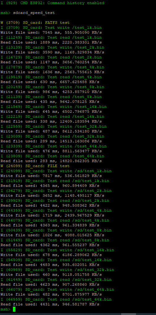

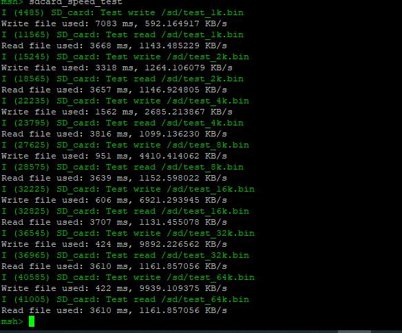

Hi, is the reading speed always the same no matter how big or small the file is?
Jinsc_esp32
Posts: 7
Joined: Sun Apr 17, 2022 7:16 am
Re: In SDIO four wire mode, the file reading speed is very slow and the writing speed is normal
Postby Jinsc_esp32 » Mon Apr 18, 2022 1:38 am

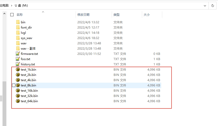

The file read is the file written earlier
The file size is consistent, but the cache used in reading is 1K ~ 64K respectively
igrr
Posts: 2077
Postby igrr » Mon Apr 18, 2022 7:42 am
You can increase read speed by bypassing the file stream buffering.
Please try replacing fread call with read(fileno(fd), buf, len);
(However, if you use 'read', take care not to use 'fread' with the same file stream as well)
Jinsc_esp32
Posts: 7
Postby Jinsc_esp32 » Mon Apr 18, 2022 2:10 pm
The speed of reading files using FatFs is normal
