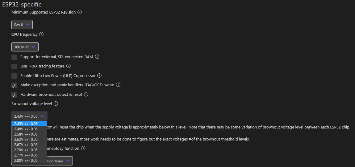

Re: ESP 32 doesn´t reboot
There is a setting in menuconfig that allows you to adjust the Brownout voltage level. Have you tried playing with this?
