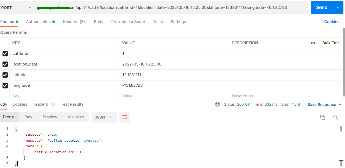

I am trying to make an HTTP Post request using Arduino for ESP32. I am using the HTTPClient library to make the Post request in which I have to use the Authorization Bearer token. Below is my code.

I have tried both Content-Type and even without any Content-Type.
My ESP32 is successfully connecting and getting a valid IP Address. After making the Post request, I am getting
HTTP Response code: 400
I have checked the same Post request using Postman and I am getting the right response. Details of Postman's request are below.
Looking for advice to make it work, maybe it's trivial for experts.
Regards

Problem solved.
Below is the updated code. Hope it will save someone's time.
