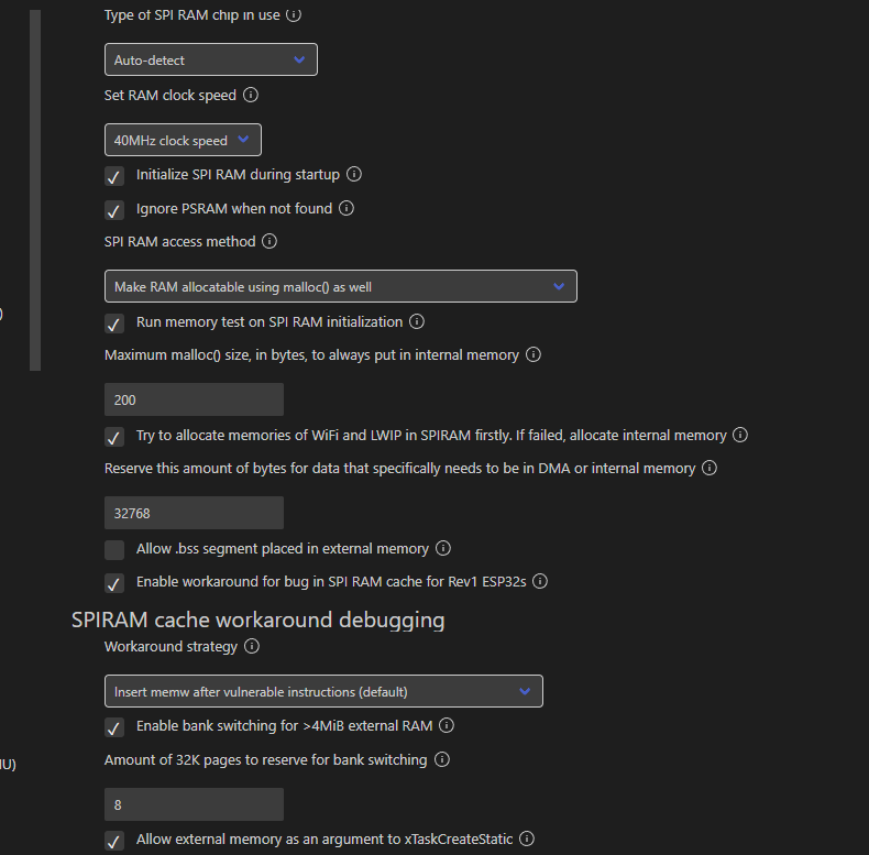

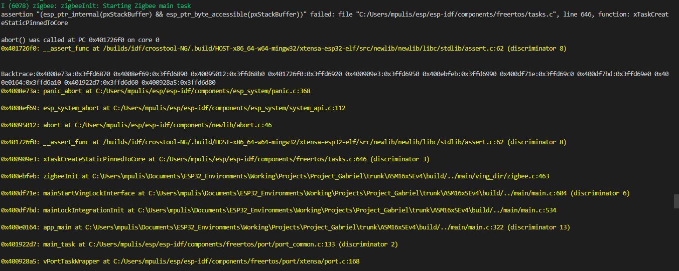

I'm attempting to start a task with memory allocated in the PSRAM. When using xTaskCreateStaticPinnedToCore to start the task, the ESP32 is crashing.
The code being used to start the task is below. I'm also including a snapshot from sdkconfig and also the crash message.
The chip being used is a WROVER-IE. ESP IDF is version 4.3.1.
StaticTask_t _x_zigbee_task_buffer;
StackType_t _x_zigbee_task_stack;
_x_zigbee_task_stack = (uint8_t*)malloc(ZIGBEE_STACK_SIZE);
xTaskCreateStaticPinnedToCore(&zigbeeProcessTask, "zigbeeProcessTask", ZIGBEE_STACK_SIZE, (void*)skip_intitialization, 2, _x_zigbee_task_stack, &_x_zigbee_task_buffer, 1);

Thanks for the link! But if that's so, then what's this configuration for?

Postby mpulis » Tue May 17, 2022 11:22 am
Sorry for the bump, but does anyone know what this configuration is for?

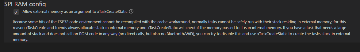

I never used this thing before, but I found this in the IDF Documentation:
The option CONFIG_SPIRAM_ALLOW_STACK_EXTERNAL_MEMORY can be used to place task stacks into external memory. In these cases xTaskCreateStatic() must be used to specify a task stack buffer allocated from external memory, otherwise task stacks will still be allocated from internal memory.
Maybe you can not pin to core your task.
https://docs.espressif.com/projects/esp ... l-ram.html
https://docs.espressif.com/projects/esp ... nal-memory
But the explanation is not so clear you can try enable this to cause xTaskCreateStatic to allow tasks stack in external memory. this is funny. :lol:
Sorry but I have no other Idea for you. I tried a lot of thing with ESP but this is something what I never use it.

Fair enough, I appreciate the honest response! It doesn't seem to be working, so maybe it's an inaccessible feature :?
For now I'll steer clear of using it.
Posts: 10645
Re: xTaskCreateStatic crashing
Postby Sprite » Wed May 18, 2022 11:56 am
Fwiw, it sounds like it may be a bug in esp-idf to me... could you perhaps open an issue on our Github for this? If it indeed is a bug, we can deal with it, if not, we need to at least document why this is caused.
