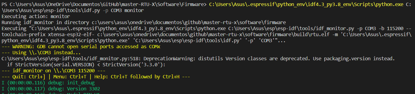

Can you run monitor on Windows? Are you sure COM3 is the correct port? Are you sure nothing else (`idf.py monitor`?) is running and blocking your connection?
Palonso
Posts: 95
Joined: Tue Sep 24, 2019 8:43 pm
Re: Can't program the ESP32 with VSCode
Postby Palonso » Thu May 26, 2022 3:17 pm
Yes I can, here is a picture of it running:
Screenshot 2022-05-26 120644.png (49.11 KiB) Viewed 7690 times
I'm also sure COM3 is the correct port since is the only port installed/detected:
Screenshot 2022-05-26 120855.png (19.88 KiB) Viewed 7690 times
And nothing else is running 'idf.py monitor' therefore blocking the programming process, any idea what is happenning?

Could be a timing issue. Can you connect an 10uF capacitor between the EN line of the ESP32 and ground? Alternatively, you can also check if programming while holding the IO0 button (if your board has it) or grounding GPIO0 works.
