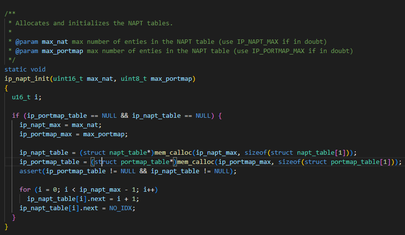

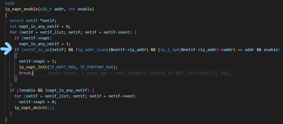

I'm trying to enable NAT by using lwip from esp-idf, but the function to do it seems that isn't working properly.
The first image shows the "if" that must work to execute the ip_napt_init function where the necessary structures are initialized, but here this 'if' is never executed, so the NAT is never enabled. This function do not returns a error when the process did not work properly, so I will know that it didn't work only when I try to disable the NAT, in this case, the ip_napt_deinit is called (more below in the same image).
Captura de Tela (54)_LI.jpg (1.64 MiB) Viewed 3525 times
The second image is the code from ip_napt_init
Captura de Tela (56).png (43.52 KiB) Viewed 3525 times
The third image is ip_napt_deinit function, the board is crashing because it tries to free a memory that wasn't allocate before.

Most probably, your interface is either not up yet, or it has not been allocated an IP address. Quick workaround would be to sleep for a couple of seconds (until interface is up and DHCP allocates an IP address to it). Better solution would be to check the status of the interface using
esp_netif_is_netif_up()
function. Then, all you need is to wait until the interface is up and running before calling
ip_napt_enable()
for that interface. Hope it helps.
