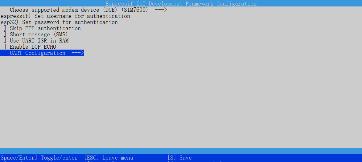

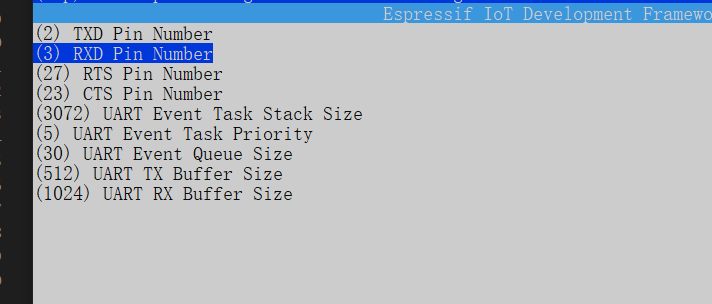

idf4.4.1 -pppos_client_main demo 烧入到板子中不停的重启
Marco_ma
Joined: Thu Dec 24, 2020 1:01 pm
Postby Marco_ma » Tue Jun 14, 2022 8:08 am
芯片型号 ESP32C3 +SIM7600 PPP拨号 模块一直复位

E (820) esp-modem: esp_modem_dte_send_cmd(256): process command timeout
E (820) dce_service: esp_modem_dce_sync(225): send command failed
E (820) bg96: bg96_init(167): sync failed
Guru Meditation Error: Core 0 panic'ed (Store access fault). Exception was unhandled.
WeChat Image_20220614160701.png (17.36 KiB) Viewed 1837 times
WeChat Image_20220614160655.png (22.12 KiB) Viewed 1837 times

Postby netmark » Tue Nov 08, 2022 2:14 pm
你这是串口不通自动复位
