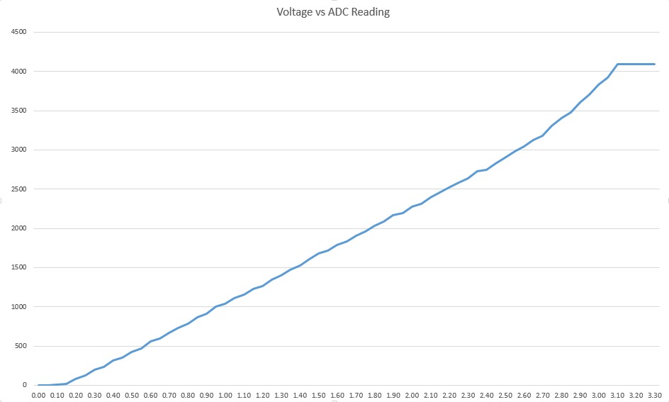

I have been trying and failing to get a NodeMCU ESP32-S Dev board to properly read two analog inputs (voltage). It appears the inputs are very non-linear and there is a good amount of noise.
I'm am using the following board for my testing; https://www.amazon.com/gp/product/B0718T232Z/
I have downloaded the firmware repo, built the firmware, and flashed it two days ago so I should be running up to date firmware.
I am using a known good voltage output (which I can set to whatever value) along with testing the voltage to verify its correct.
With the above said I went through and mapped out the voltage vs ADC value and what I found was under around 0.1 v the ADC didn't see anything and above around 3.08v the ADC just reads 4095. I've attached the data and here is the graph:
Based on this I'd like to try to switch to the -6db attenuation and also the 11 or 10-bit width and retest. However I don't know how to do this. I can fiddle with Arduino but I can't seem to get the commands right and I'm wondering if I even can from there. I'm assuming I can change the default from the -11db and 12-bit somewhere in the source code and recompile the firmware and reflash it but again I'm not sure how to do that.
Can anyone guide me on the changes I need to make to either add something to my sketch to change these settings on a entire ADC or pin by pin basis or what to change in the firmware code?

Those calls seem to work for me. Note: there's been plenty of discussion of non-linearity of the ADC.
See:
https://github.com/espressif/esp-idf/issues/164

Posted: Wed Sep 06, 2017 3:21 am
by mnemonix
....I'm not sure what else I can try.
Maybe you can learn a bit of C, for example how to call a function instead of just declaring it? ;)
Here is a stripped down version of what I used to test the ADCs (I've not tested if it works in this minimal version):
int n = 0;
void setup()
    Serial.begin(115200);
    analogSetWidth(10);                           // 10Bit resolution
    analogSetAttenuation((adc_attenuation_t)2);   // -6dB range
void loop()    //ADC Test
    int av = analogRead(2);                       // ADC12 on GPIO2
    for(n=1; n<8; n++) av += analogRead(2);
    av /= 8;
    Serial.print(" ADC12 = ");
    Serial.println(av,DEC);
    delay(200);
