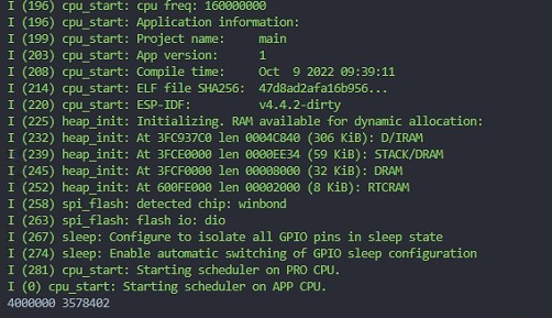

在ESP-IDFv4.4.2中,经过测试,
-time()是可用的,应该clock()也是可用的
-scanf()仅仅能获得FIFO中的数据,无法阻塞,是可用的,但不建议使用
-fopen等API都是可用的
-原子类是可用的,并且真正有用
除原子类外,其他API都可以在文档中找到,原子类的测试代码和测试效果如下:
```c
#include <stdatomic.h>
#include <stdio.h>
#include "freertos/task.h"
atomic_int acnt;
int b = 0;
void task1(void* arg) {
for (size_t i = 0; i < 1000000; i++) {
atomic_fetch_add_explicit(&acnt, 1, memory_order_relaxed);
b++;
vTaskDelete(NULL);
void task2(void* arg) {
b++;
vTaskDelete(NULL);
void app_main(void) {
atomic_init(&acnt, 0);
xTaskCreate(task1, "1", 1024, NULL, 1, NULL);
xTaskCreate(task2, "2", 1024, NULL, 1, NULL);
xTaskCreatePinnedToCore(task1, "1", 1024, NULL, 1, NULL, 0);
xTaskCreatePinnedToCore(task2, "2", 1024, NULL, 1, NULL, 1);
vTaskDelay(pdMS_TO_TICKS(5000));
int a = atomic_load_explicit(&acnt, memory_order_relaxed);
printf("%d %d\n", a, b);
``` 所以,newlibc现在已经被乐鑫完美移植,可以无限把ESP32==Linux进行开发。

Re: [Answered] How much of newlib is implemented/mapped/usable on ESP32?
Adding to this, it's possible to use 'scanf' as well, however you first need to initialize the UART driver and reconfigure the console to use it. Please refer to this comment: https://github.com/espressif/esp-idf/is ... 1233893079.
