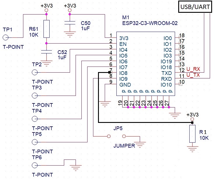

I am struggling to flash for first time my custom board with ESP32-C3-WROOM-02-H4.
You can see attached my schema, where R1 has been added by rework after first failed try.
When I connect board to my pc through a USB/UART adapter (FTDI232) I receive following answers:

Which I suppose that means that ESP32 is trying to access flash but there is no valid program flashed.
After pulling down GPIO9 at startup no message emerges from UART/USB port, but esp-idf tool is not able to connect
Could anyone help to find out what I am doing worng?
That is a bit suspect; you should still get a startup message (similar to the first three lines of the normal boot message) when starting in download mode. Are you sure you're not seeing that? If not, perhaps there's a short between GPIO9 and something else?

I have found that adding a 100nF capacitor to GPIO9 boot pin fixed the error

After adding a capacitor of 100nF to GPIO9 I have been able to receive following start up message, but I am still not able to flash

I have found the solution my TX pin was share with uC TX which forced it to high level
Posts: 10596
Re: ESP32-C3-WROOM-02-H4, No serial data received.
Postby Sprite » Fri Jul 29, 2022 2:18 am
That'll do it :) glad you found the error.
