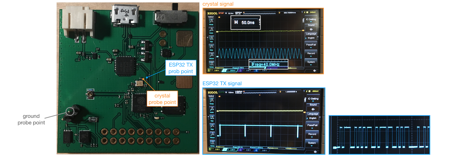

Board in question:

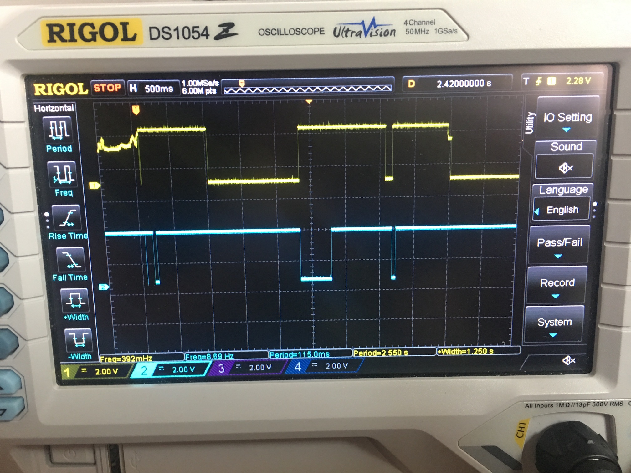

Tried holding GPIO0 and/or EN low, holding GPIO2 high, and various combinations but no good results. When I just leave the board be, signal on GPIO0 and EN at flash is:

- Can you check if your crystal is actually oscillating? I think the ROM should initialize the crystal oscillator, so you should at least see bits of 40MHz waveforms there.
- With GPIO15 being high, the ROM should be pretty chatty on the serial port. With an empty flash, it should either boot into download mode or possibly the Basic interpreter (and/or a boot loop, depending on the fuse settings). Can you see if that's the case?

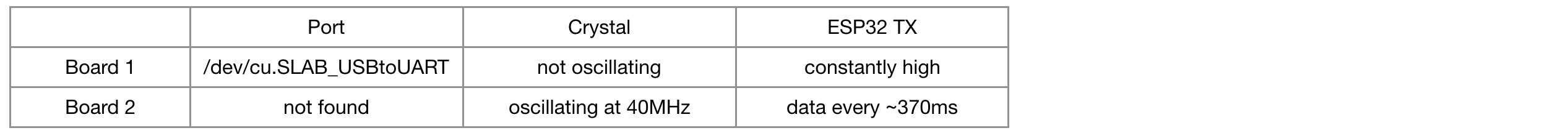

- the crystal is not oscillating
- ESP32 TX is constantly high

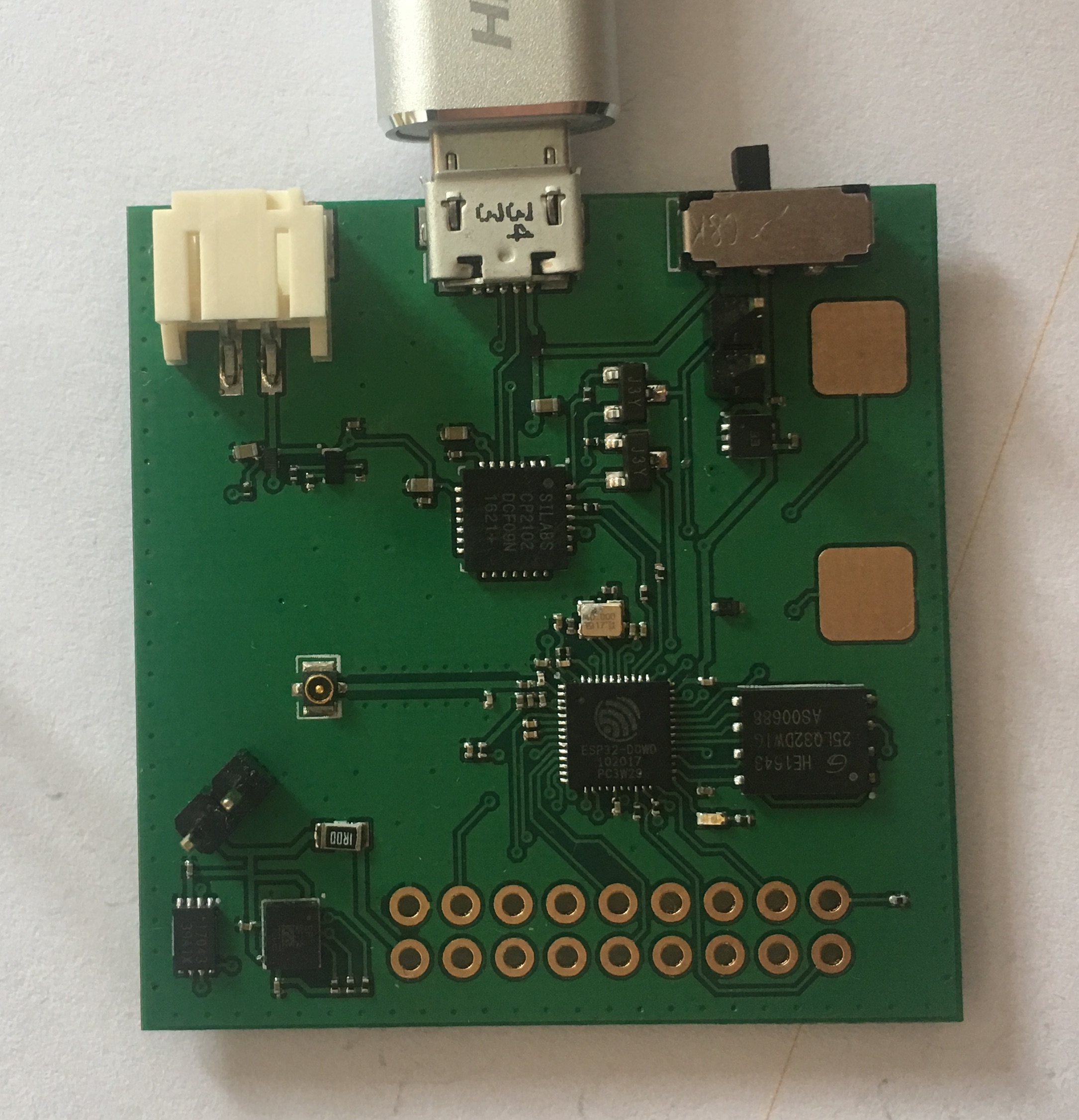

I did make a duplicate board, and that one looks more lively (gave up on it early because CP2102 didn't even show up with ls /dev/cu.*). Comparison of the two boards:
board situation.png (60.73 KiB) Viewed 7211 times
Measurement location and results for Board 2:
what was measured.png (956.16 KiB) Viewed 7211 times

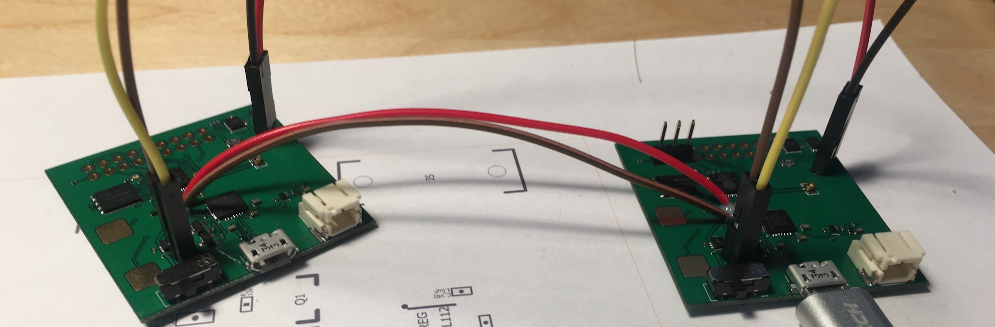

I stitched the two boards together and was able to get a connection and successfully upload a program via command line. Didn't need to hold GPIO0 low.
stitched board.JPG (247.33 KiB) Viewed 7211 times
I'm curious why Board 1 didn't work. What do you think I should do to troubleshoot further?

Could be a fair amount of things... bad solder joint somewhere, power supply issues. broken crystal... you name it.
