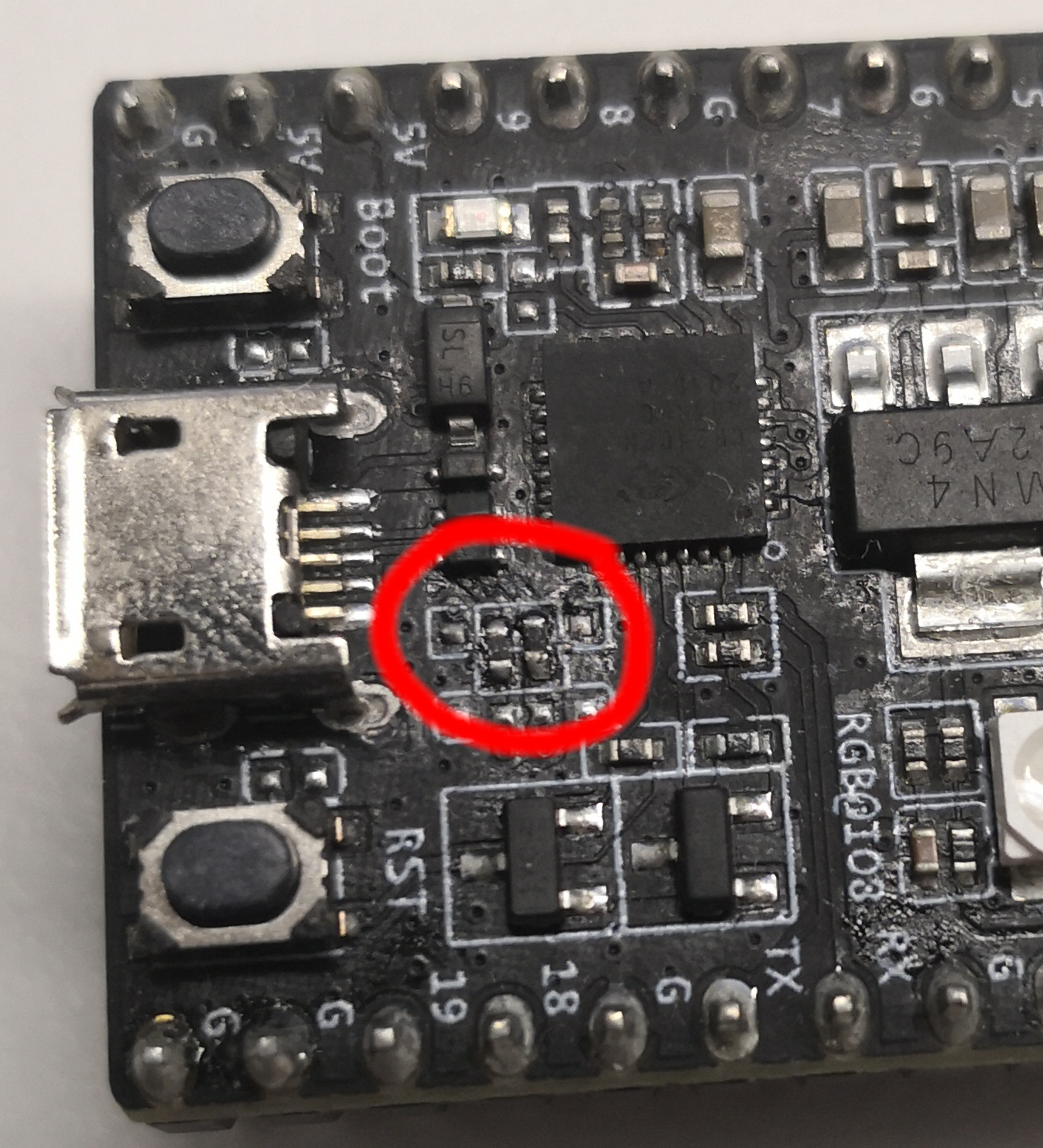

i am trying to access the jtag functionality in "ESP32-C3-DevKitC-02" but a jtag port does not appear in the device manager.
i looked in the menuconfig and tried both usb_serial_jtag_port and usb serial/jtag controller
but does not see how to connect to the supposed onboard jtag controller
i tried replacing the silabs driver but that did not help too
i tried going with the getting started guides but the openocd doesn't find the jtag device.
if anyone knows how to use that and help, thanks.

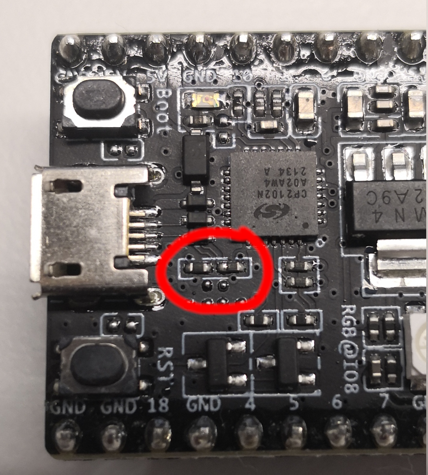

That devkit by default connects to an USB-serial chip (the Silabs one) rather than directly to the ESP32. If you want to connect directly, either you can make your own cable connecting to GPIO18/19 (ref) or move 2 SMD resistors so the micro-USB port connects to it.

Regarding changing the resistors, you can refer to the pictures. "us_uart_bridge.jpg" refers to the default setting when you buy a development board. If you want to use the integrated USB serial/JTAG on the micro-USB port of the board, you need to change the resistors to the orientation shown in "usb_serial_jtag.jpg". The resistors are quite small, so creating your own cable and connecting it as ESP_Sprite suggested, might be easier.

yes, this was my problem.
i finally connected a custom patch cable to gpio18/19 and it works now
thank you.
