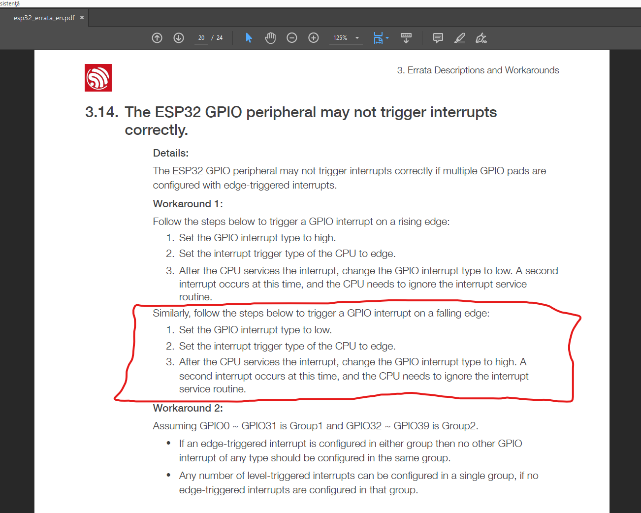

Hello, I want use the interrupts on pins I35 and I39 and if turn on WiFi module intterupt on I39 pin it doesn't work properly, if turn off WiFi module working fine interrupt on I39 pin. So I found in esp32_errata_en.pdf "Section 3.11 for the detailed description of the issue" but I don t understand what tot do? Can you help-me, thanks!

I tried a workaround from the errata file (attached picture) but it has no effect, what could be wrong with my code?
