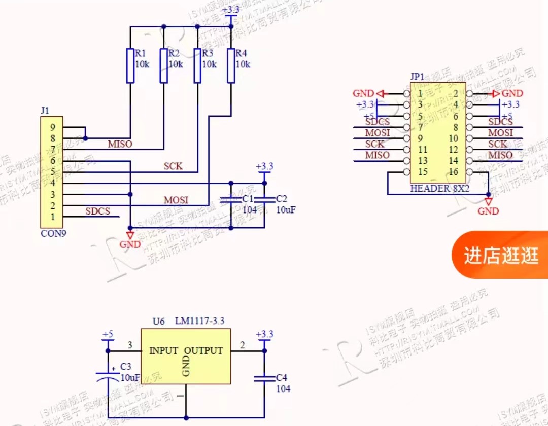

实现ESP32-WROVER-IE写入数据到SD卡中时无法初始化sd卡(idf 4.4)

E (748) vfs_fat_sdmmc: slot init failed (0x103).
E (749) sd.h: Failed to initialize the card (ESP_ERR_INVALID_STATE). If you do not have an SD card attached, please ignore this message. Make sure SD card lines have pull-up resistors in place.

SD卡模块如下图,SD卡:Sandisk SDHC 32G
