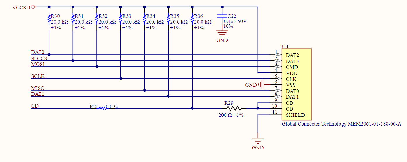

I am trying to use an SD Card with the ESP32-S3-WROOM-1-N16 on a custom PCB - ATTACHED Schematics below.
I have tried both the SD.h library and the SdFat.h.
PIN CONFIGURATION:
VSPI_MISO 40
VSPI_MOSI 41
VSPI_SCLK 39
VSPI_SS 38
f_mount failed: (3) The physical drive cannot work

Any ideas on how to get this up and running? The resistors that are pulling up the data lines have the value of 20kOhms, I've read on some posts that the recommended are 10kOhms, it should not make any difference really. Any suggestions?

That comment in your code about initializing the SPI busses doesn't actually do it. There's no default pins on the S3, so you need to begin the SPI yourself to define the pins. Set the core debug level to verbose, and it may give you a bit more detail. Your schematic looks ok, and 20k should work if you have short connections b/w the devices. Note that if you want to use the extended data lines, you should be using the SD_MMC library.
void setup() {
   Serial.begin(115200);
   SPI.begin(39, 40, 41, 42);
