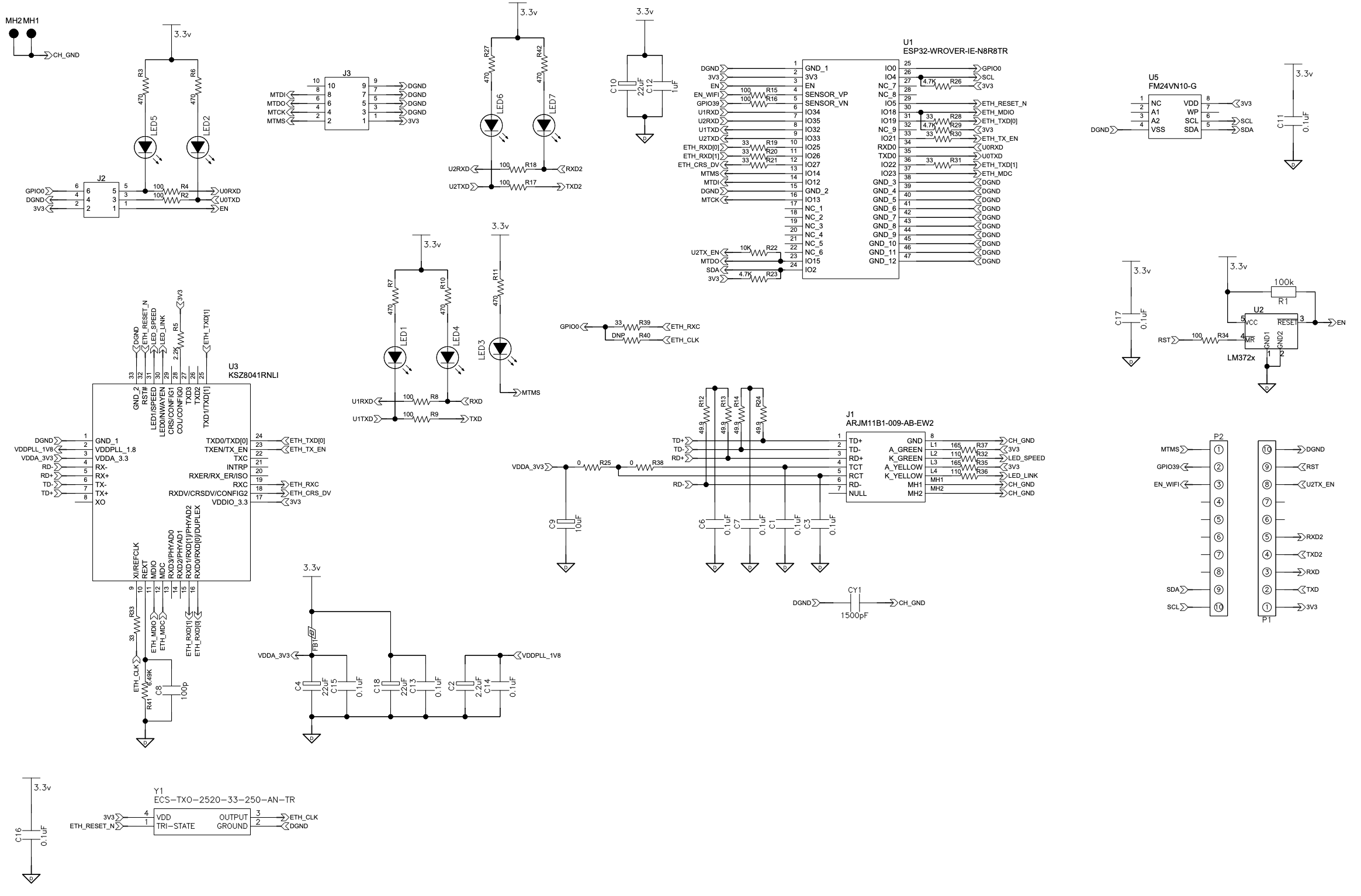

Hm, that's one unhappy puppy... Just to check, can you share the (relevant bits of) the schematic?

Postby jamesarm97 » Thu Dec 29, 2022 6:22 pm
Here is schematic, mostly bits taken from the ESP32-ETH-KIT with the phy replaced with a RMII compatible chip.
Posts: 10619
Re: ESP32-WROVER-IE-N8R8 programming errors
Postby Sprite » Fri Dec 30, 2022 3:03 am
Nothing odd there... Can you tell me a bit more about the power supply? How is the 3.3V generated; are you sure that has enough headroom to pull a good 500mA from that rail?

jamesarm97
Posts: 10
Joined: Tue Dec 27, 2022 4:25 pm
Postby jamesarm97 » Mon Jan 09, 2023 10:08 pm
So I unsoldered the ESP32 wrover module and put wires on every pin and put a socket on the board then proceeded to plug in every wire one at a time. With just power, EN, IO0 and RX/TX I was able to get the flash id and it shows 8MB. It appears that IO2 is the culprit. We have a pull-up on IO2 so we can use it for I2C SDA but I think we are seeing an undocumented mode if IO0 is low and IO2 is high. I don't see that in the boot table and don't see any mention of what it can cause, but IO2 connected is causing esptool to not detect the flash id or type.
Manufacturer: c8
Device: 4017
Detected flash size: 8MB
