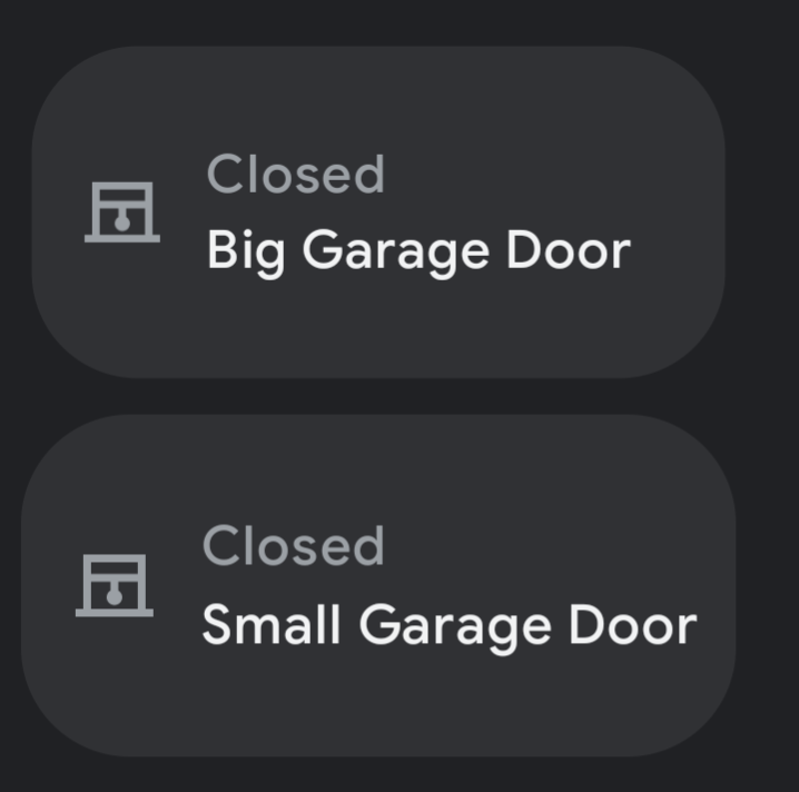

I have it set up now that the Google Home app is recognizing it as a garage door, however, I can't seem to get it to update.
static Device garageSensor1("Garage Door 1", ESP_RMAKER_DEVICE_GARAGE_DOOR);
Param garagePosition("Garage Position", ESP_RMAKER_PARAM_GARAGE_POSITION, value(0), PROP_FLAG_READ | PROP_FLAG_WRITE);
Param garageLock("Garage Lock", ESP_RMAKER_PARAM_GARAGE_LOCK, value(0), PROP_FLAG_READ | PROP_FLAG_WRITE);
int state = digitalRead(hallSensor1);
  garageSensor1.updateAndReportParam("Garage Lock", state);
Updates just fine in RainMaker app, just not with Google.

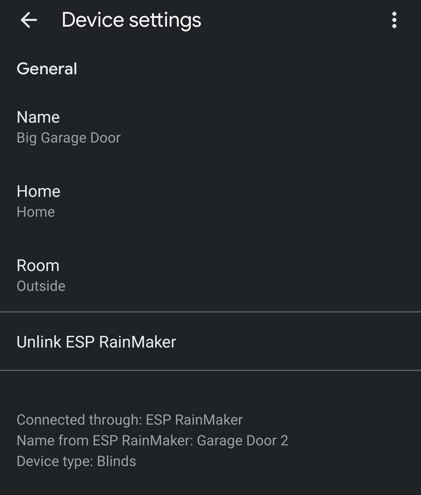

I actually just ended up changing the device to blinds and the parameter to blinds position.
Didn't change anything else about the code, Google now displays the information (open or close) in the app. The device shows up as "blinds" instead of "garage" but that's just a minor inconvenience.
Must be the way RainMaker is reporting the information to Google.
