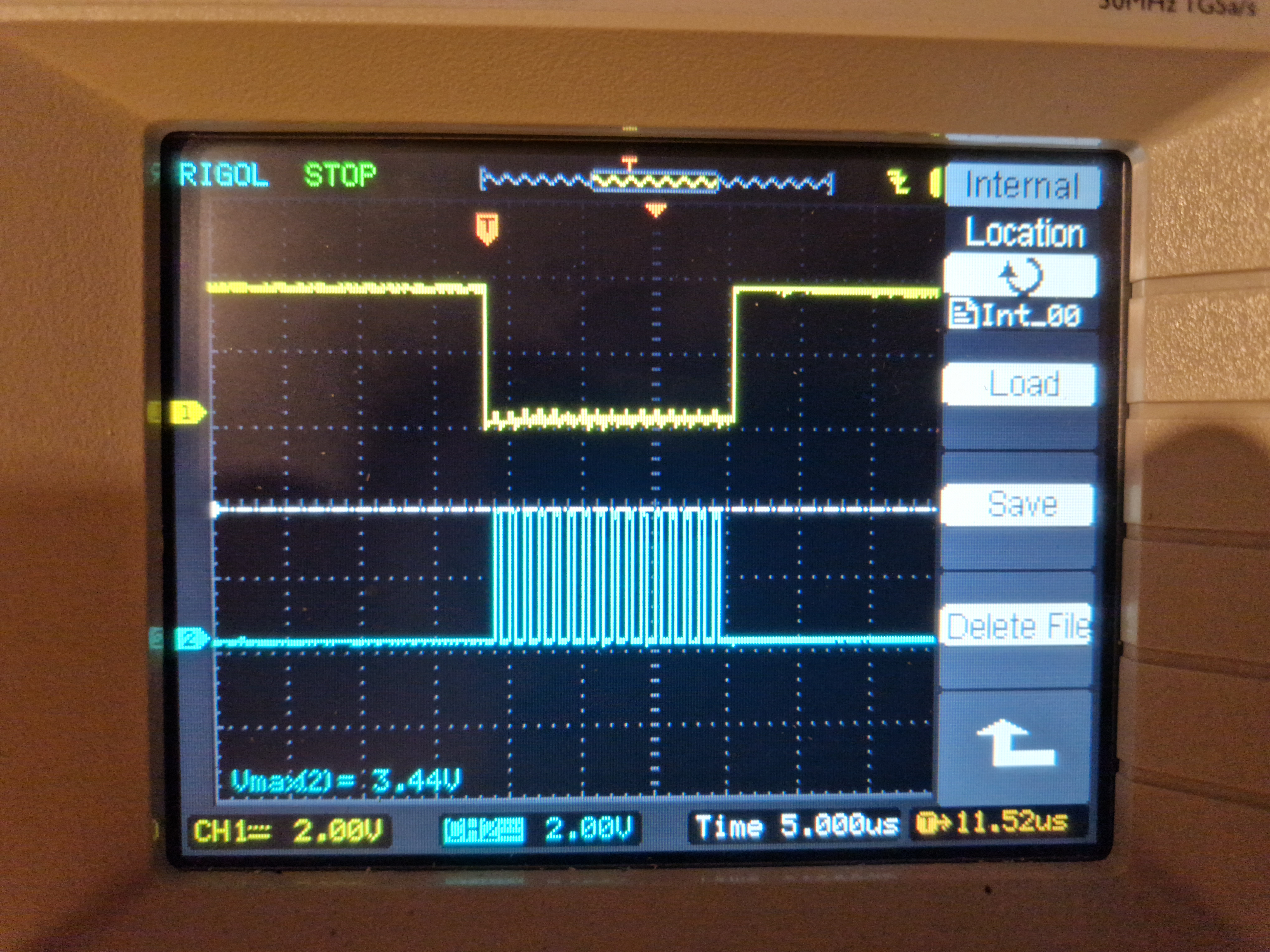

i have a 2 probe scope, triggered by !CS in attach what i see with the following transaction:
    spi_transaction_t t;
    memset(&t, 0, sizeof(t));       //Zero out the transaction
    t.length = 8+8*len;
    t.rxlength = 8*len;
    t.tx_buffer = NULL;
    t.rx_buffer = reg_data;
    t.addr = reg_addr;
Clk line, i see 16 clock pulses and seems right

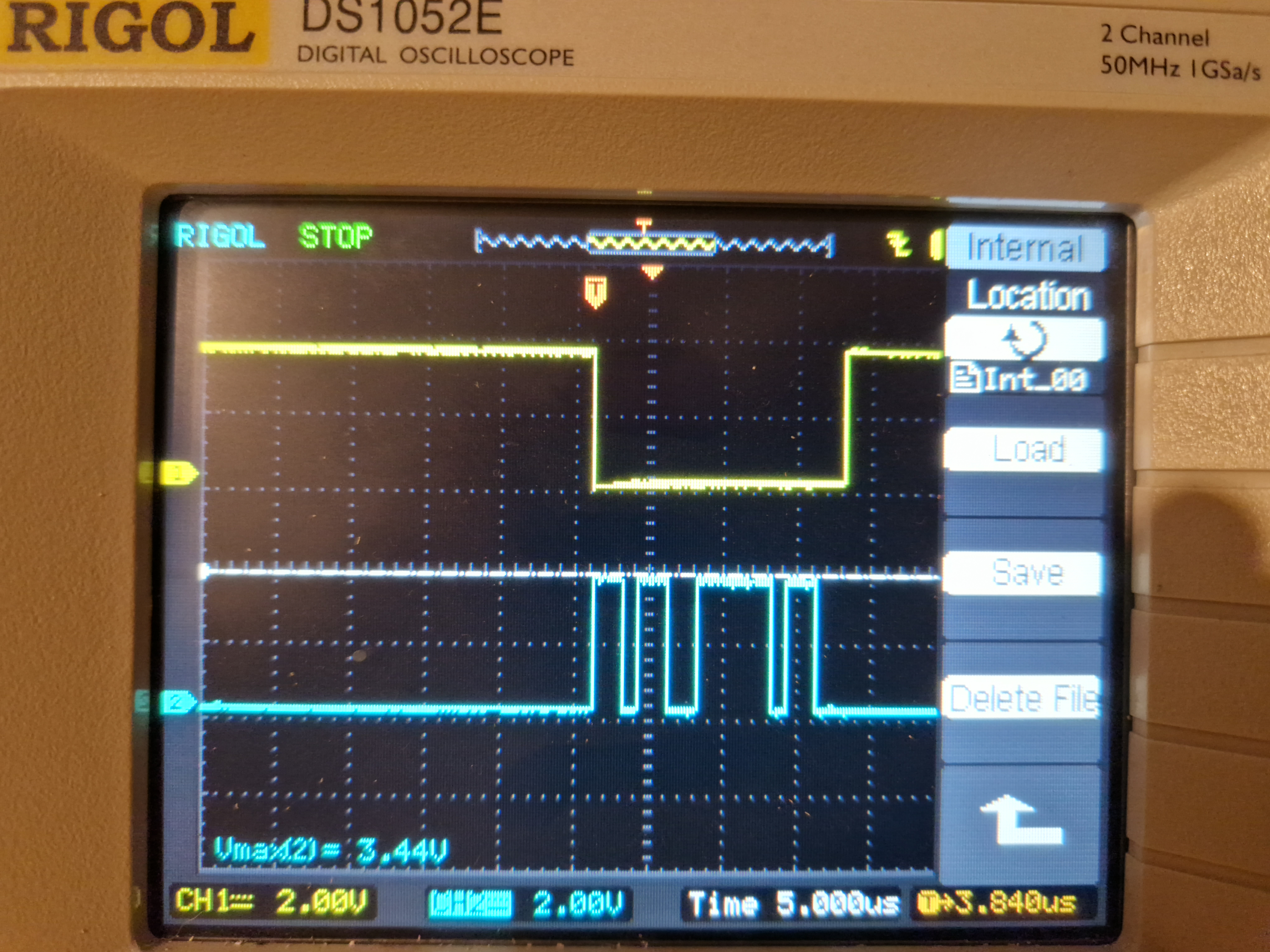

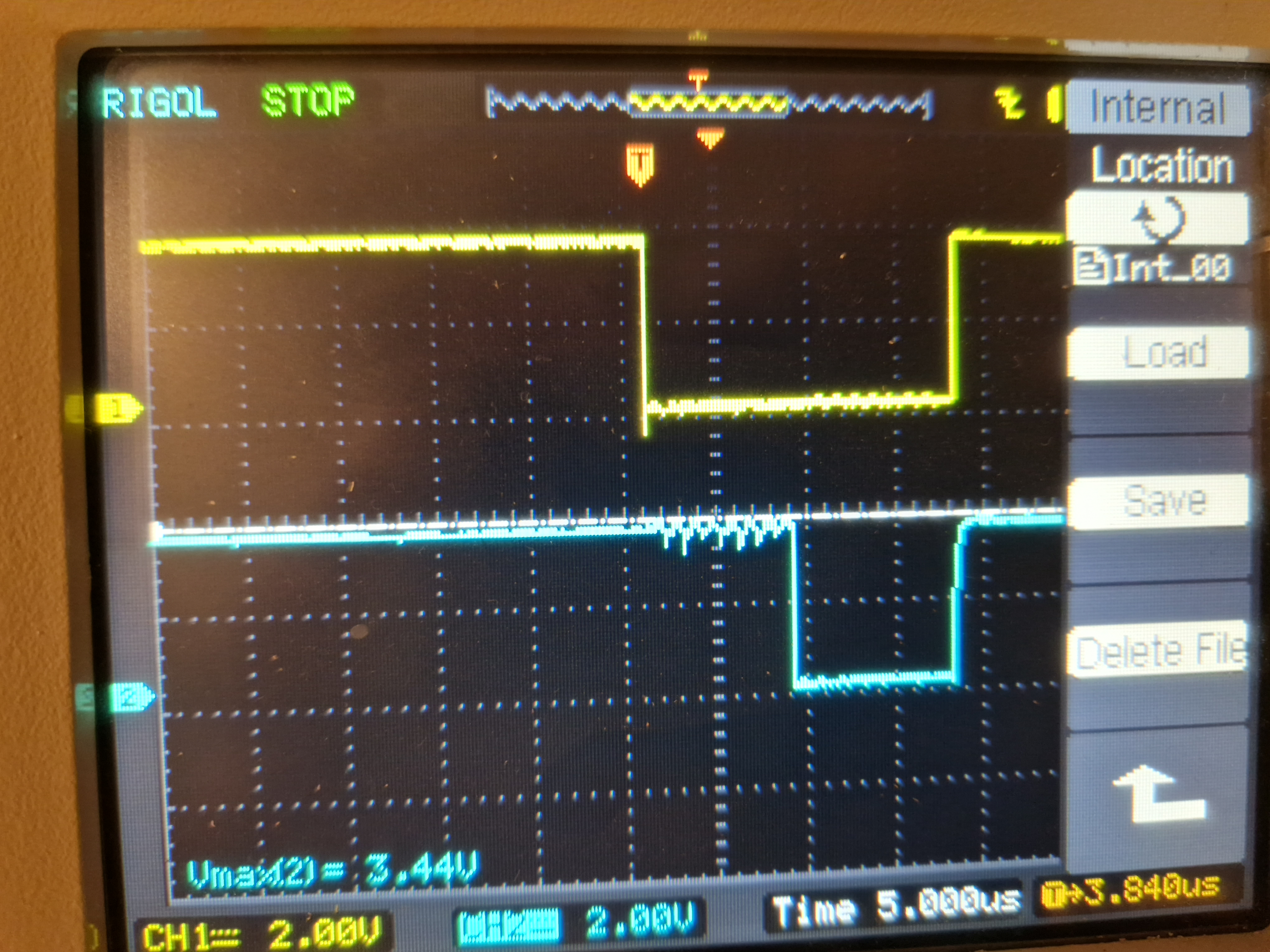

Miso line, after 8 click cycles it goes to 0, i suppose this is why i read 0xFF from it
Mosi line, it transmit for all 16 clock cycles and seems incorrect to me
--- edit ---
with following transaction
    t.length = 8+8*len;
    t.rxlength = 8*len;
    t.tx_buffer = &reg_addr;
i get some data in mosi/miso lines but in reg_data i still read 255... any ideas?
