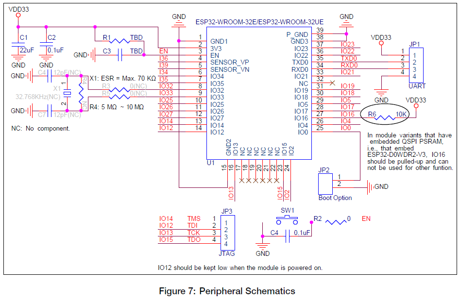

I am working on the Project in which I am using ESP32 WROOM 32E and this Project will be Battery Operated.I want to implement external RTC crystal feature.
As shown in attached image,
R4 resistor value in the range of 5M ohm to 10M ohm. So how to choose proper value, can suggest specific value of this resistor.
Thank You

You could mount 10M as initial value, if it does not work, you could decrease the value until crystal works.
