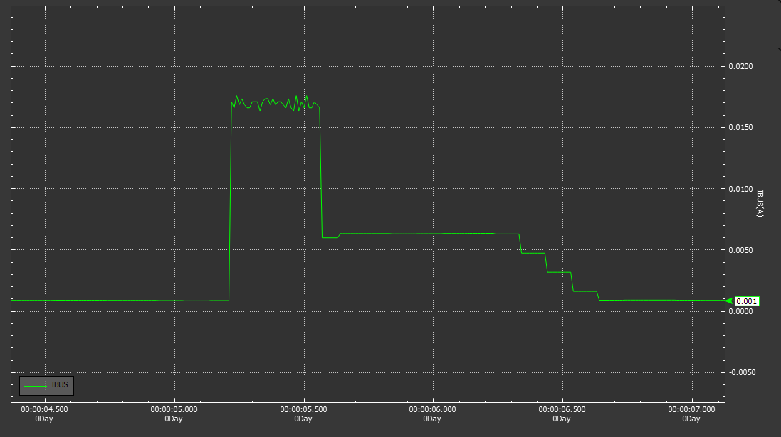

We have some issues regarding the timing of going to sleep.
while sending the SOC to light sleep the current consumption is still high for another second and only then the current goes down to light sleep mode consumption.
light sleep, current consumption.
testing info:
ESP32-C3-DevKitM-1
the code is simple - stay awake for 350ms then go to sleep, wake up by timer after 5 sec or GPIO button.
have you seen the same behavior? any idea how to cut the time to go to sleep?
