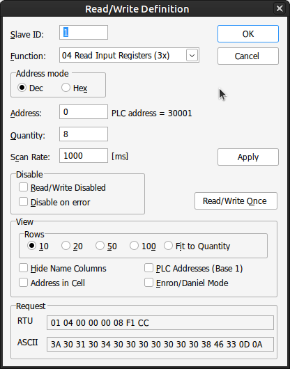

I'm testing Modubs RTU example.
Whenever I tried to read Input Register value.
I can see 02 Illegal Data Address.
I'm using Modbus Poll window program to check Modbus communication.
other functions are working well such as Coils, Discrete Input, Holding Registers.
I use code from example here:
https://github.com/espressif/esp-idf/bl ... in/slave.c

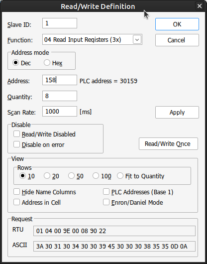

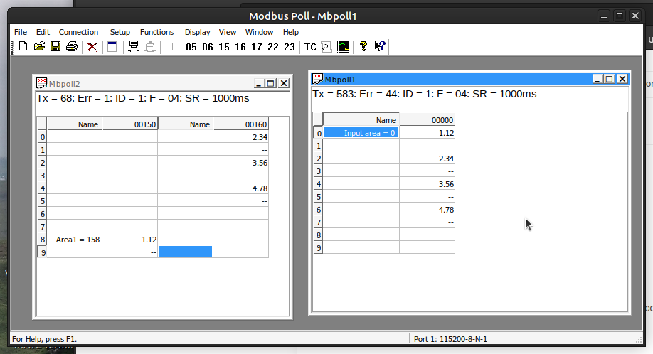

@chikichaka ,
The slave configures two register areas for input registers:
Reg input area 1: 0, length: 8
Reg input area 2: 158, length: 8
Screenshot at 2023-01-27 13-31-03.png (43.77 KiB) Viewed 4883 times
Screenshot at 2023-01-27 13-18-33.png (44.97 KiB) Viewed 4879 times
If you configure Modbus poll to read these registers you will get the data correctly.
Screenshot at 2023-01-27 13-26-29.png (49.52 KiB) Viewed 4886 times
