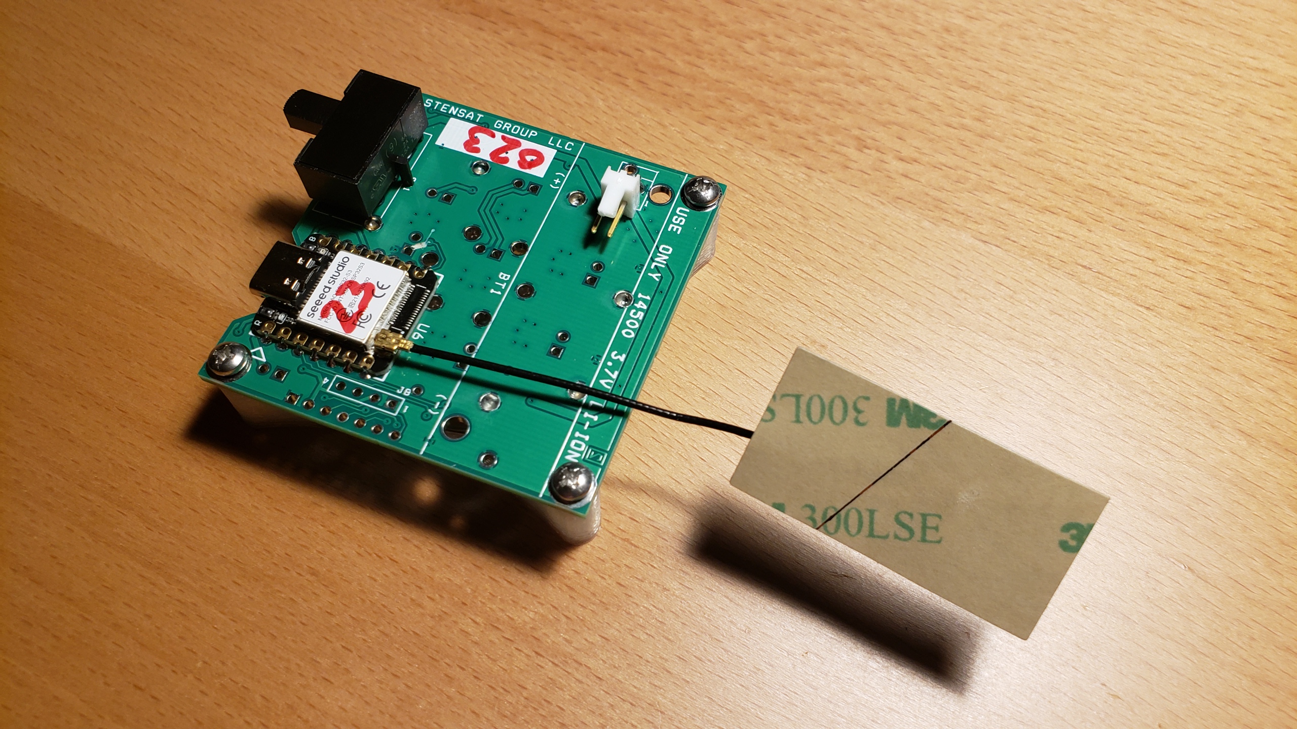

tl;dr Executive Summary: The S3 appears to have sensitivity relative to the antenna placement. Operation dramatically improves if you move the antenna further from the ESP32-S3. The issue might be reflected power from an impedance mismatch, or just near-field radiative coupling. Don't have that last bit sorted yet.
We have been using the Seeed Studio XIAO ESP32-C3 pretty extensively recently, and migrated to the -S3 for an application that required some additional CPU grunt. Our first prototypes were designed around the -C3 and worked properly with the RF segment, but were dropping frames while processing WiFi network traffic. The -C3 seems pretty indifferent to which antenna is used and where it is placed ... many of our prototypes operated fine with the factory antenna still in the "pretzel" configuration from the original packaging. (note: this pic is of the -S3 module modeling the antenna placement; don't have a -C3 module handy to take a pic.)
This did not work with the -S3 module, and it took a while to distinguish between a code issue and an environmental one. Ultimately, we noticed that if you placed a finger on the antenna, you would generally connect to the WiFi AP and start functioning. Without applying the "magic finger," the unit would sit indefinitely trying to connect to the AP but failing. Displaying verbose error messages didn't help much - the most common response was something about credential failure. Sorry, didn't retain the exact text, but it was a red herring. To confuse matters further, the WiFi Scan example code seems to work, displaying the available WiFi APs in the area. This also appears to be a distraction, because it provides the false impression that the WiFi component is working. Educated guess - the scanner doesn't transmit much, if at all, because it's not trying to connect to an AP ... it's just listening to what's available.

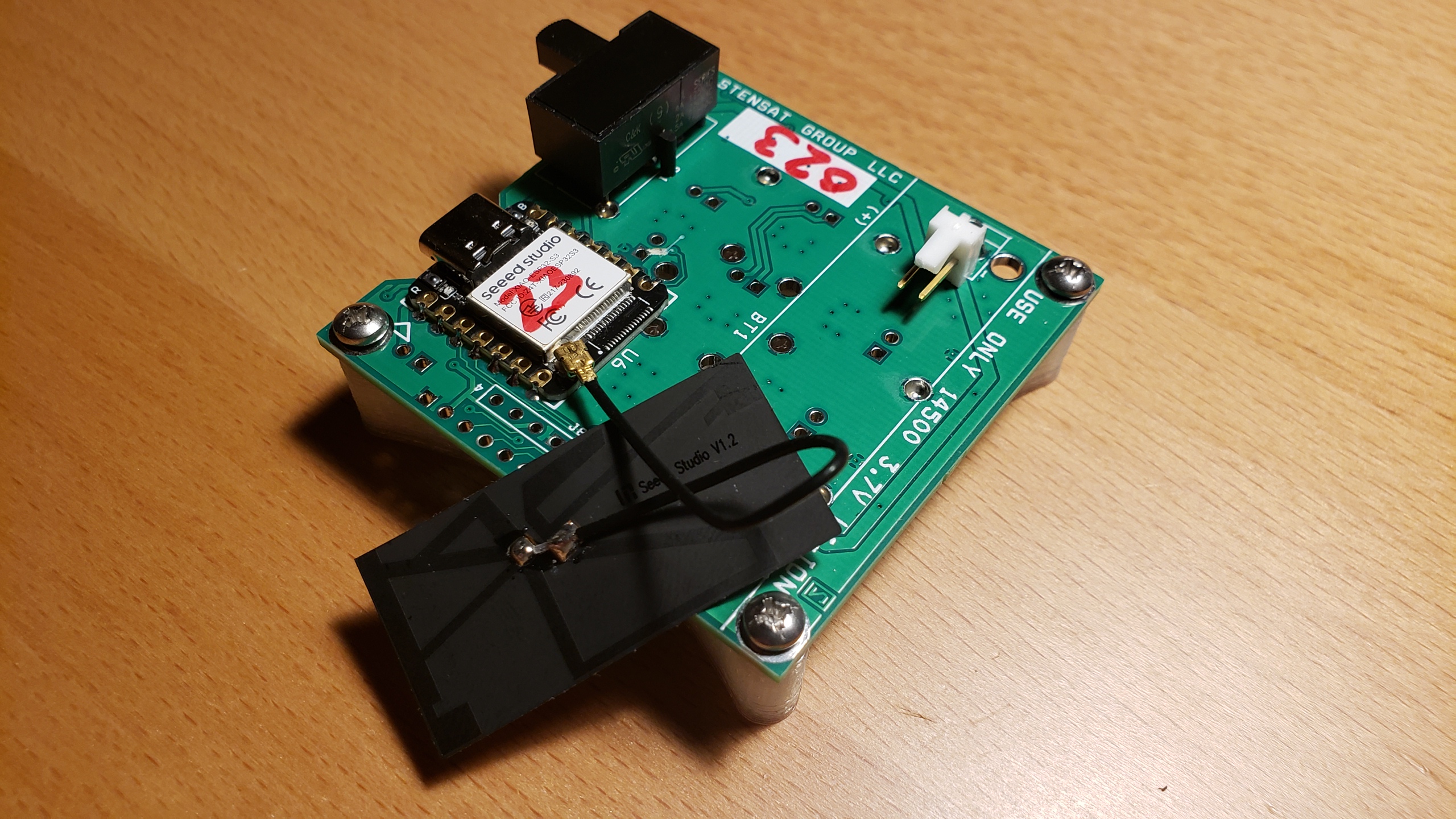

When we un-pretzeled the factory-provided patch antenna, things improved greatly. Just about all of the units would connect and interpret WiFi traffic properly. However, the system was sensitive to objects in the vicinity especially if they contained metal.

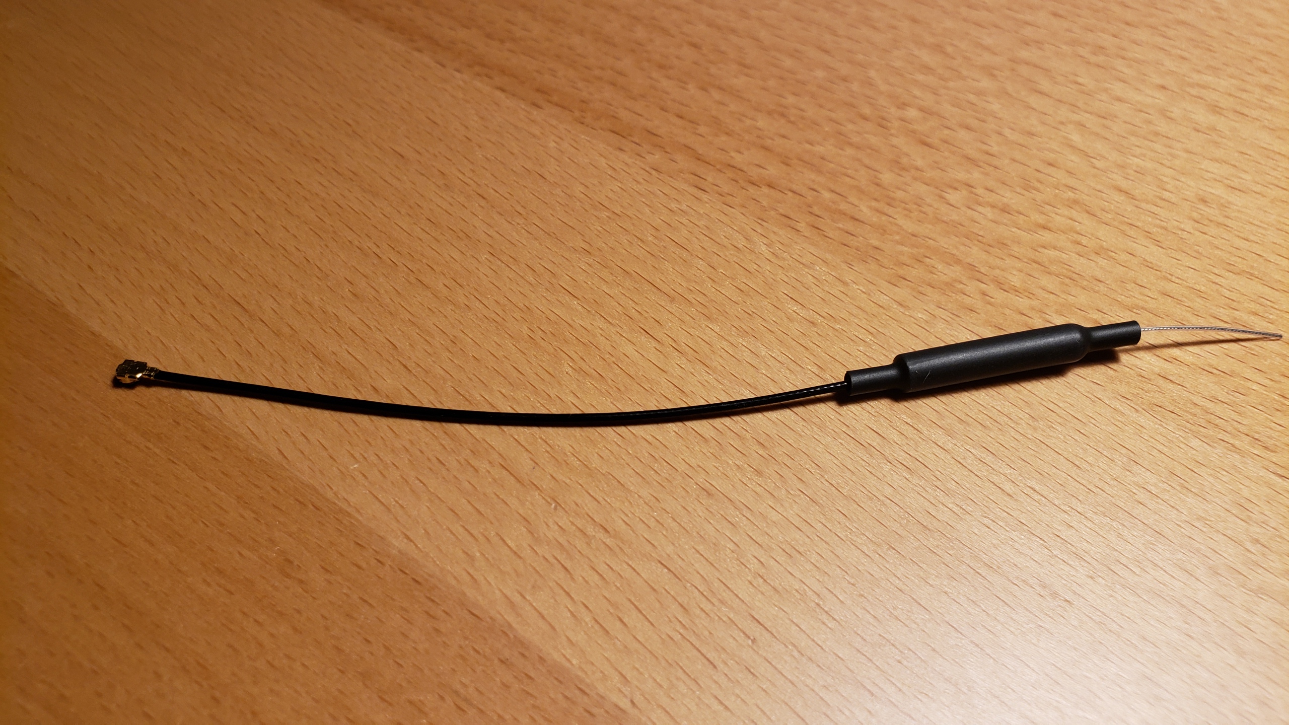

Unfortunately, our application was designed around the antenna being inside a plastic enclosure which was in-proximity to some steel support structure. It would be completely inappropriate to have this paddle of a patch antenna sticking out of the unit flappin' in the breeze (just waiting to be violently, mechanically removed by a careless installer.) Ultimately, our solution was "get the antenna further away from the CPU." That worked well, and field deployments have been successful.
This antenna was the one we chose for production deployment:
