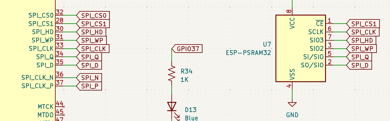

Hi all,
I'm doing a design in a custom PCB including the ESP32-S3FN8, and I have some questions about the usage of certain pins, concretely the 32, 33, 34 and 35. Theorically, according to the datasheet, these pins are used by the flash in package.
But can we also use these pins for another thing? And in this case, can we use this pins as GPIO at the same time that the flash in package is being used?

No. On the S series chips, with ESP-IDF as it is right now, it's not possible to use the flash pins for anything else. (Theoretically you could connect another SPI device to it, but software support for that is hairy so ESP-IDF does not support that at this moment.)

Anoter question related to this... We have the ESP32-S3FN8, which does not have In-Package PSRAM.
We want to use the GPIO26 (SPICS1), which according to the datasheet is used for In-Package PSRAM. As we do not have, it should be that easy to use as a normal GPIO, shouldn't be?
But when we configure this GPIO it does not work. Do you know why?
Posts: 10652
Re: Pins SPI, ESP32 S3
Postby Sprite » Tue Apr 25, 2023 8:07 am
It should, indeed. How are you configuring that pin? Does gpio_reset() help?

Postby Xavier Cavaller » Tue Apr 25, 2023 9:13 am
We are using these functions to configure the GPIO:
gpio_reset_pin(GPIO_NUM_26);
gpio_set_direction(GPIO_NUM_26, GPIO_MODE_OUTPUT);
And the, we put the GPIO to '1', but always stays in '0':
gpio_set_level(GPIO_NUM_26, 1);
We tried some other GPIOs and they work fine

Strange. You're using the chip itself, and not a module?

Postby Xavier Cavaller » Fri Apr 28, 2023 6:35 am
Yes, we are using the chip itself, concretely the ESP32-S3FN8

Hi Xavier, Hi all,
I'm having the same problem as you.
I already have my design with this ESP32S3FN8 version.
I tried to detect PSRAM on CS1 but nothing happens...
If i activate the PSRAM fuses, i get MD5 Checksum errors. (Arduino IDE)
Did you find the solution ?
thank you
