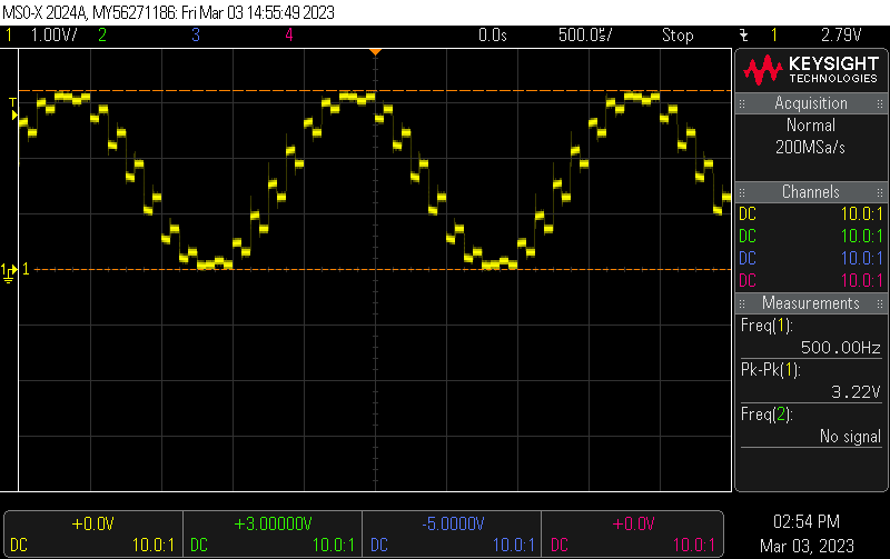

I have a very simple ESP32 program (attached) that attempts to output a 500 Hz sine wave to the GPIO25 DAC output using I2S. I configure I2S for mono (one-channel) operation. The sine wave comes from a table-lookup. The sine wave table is 32 entries (for one period). I2S is configured for 16 kHz operation so 16000 / 32 = 500 Hz. A buffer is filled with an even number of table entries to pass repeatedly to i2s_write.
When I run this it appears that every two entries are swapped when they are output to the DAC as shown with the following oscilloscope trace from the DAC output.

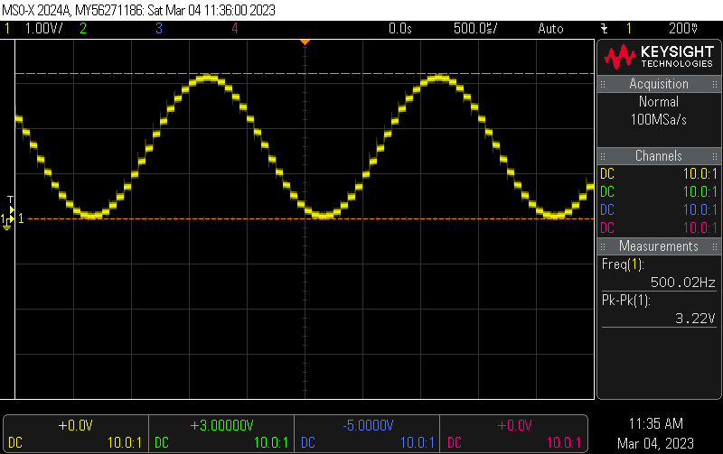

When I swap every other two entries (with the compiler define SWAP_WORDS) the output looks correct.
What is going on? Am I doing something wrong? It is interesting to note that the output is correct if I configure I2S for two channel operation, enable both DAC outputs, and load each sample twice (one for each channel).
The code is as follows (entire IDF project attached - compiled with IDF v4.4.4)

Postby Sprite » Sun Mar 05, 2023 2:20 am
SWAP_WORDS is the right solution; the I2S hardware outputs the most significant word first while the rest of the ESP32 is little-endian. It's not ideal, and I think later chips (S2, S3 etc) have a way of flipping that, but the original ESP32 doesn't.
