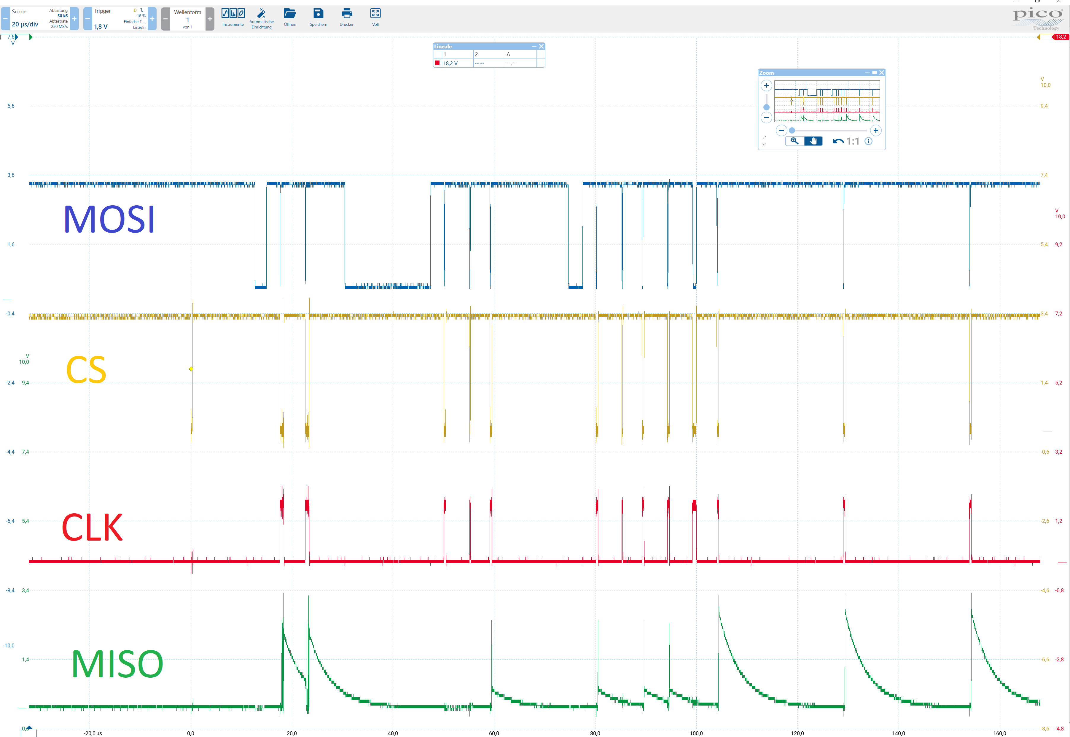

Hi all,
We are having some strange behaviour of the CS line with ESP32-S2 and SPI flash. I would expect the CS line to be low for the whole transaction. But it is only low for very short periods and during clock pulses.
Writing to and reading from the flash works fine. But we have flash corruption from time to time. So I started to check the signals.
I tried with SPI2_HOST and SPI3_HOST and also with different CS pins and several ESP32s.
CS is pulled up with a 4K7 resistor.
Flash: S25FL256SAGNFI000
Can anyone help me with this?
Thanks in advance.
Tobi

Postby Sprite » Mon Mar 13, 2023 12:24 am
Your scope is set to 20uS/div and SPI runs at 40MHz, meaning one clock cycle is 1/800th div. Are you sure you're not just zoomed out too much on your scope?

Postby tobi_ffm » Mon Mar 13, 2023 8:15 am
You are absolutely right. Oh boy :lol:
