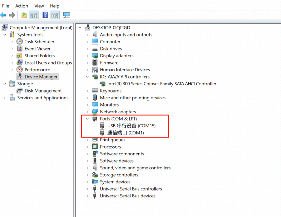

Can your PC detect the USB device under Computer Management - Device Manager?
Can you try another USB-C Cable?
