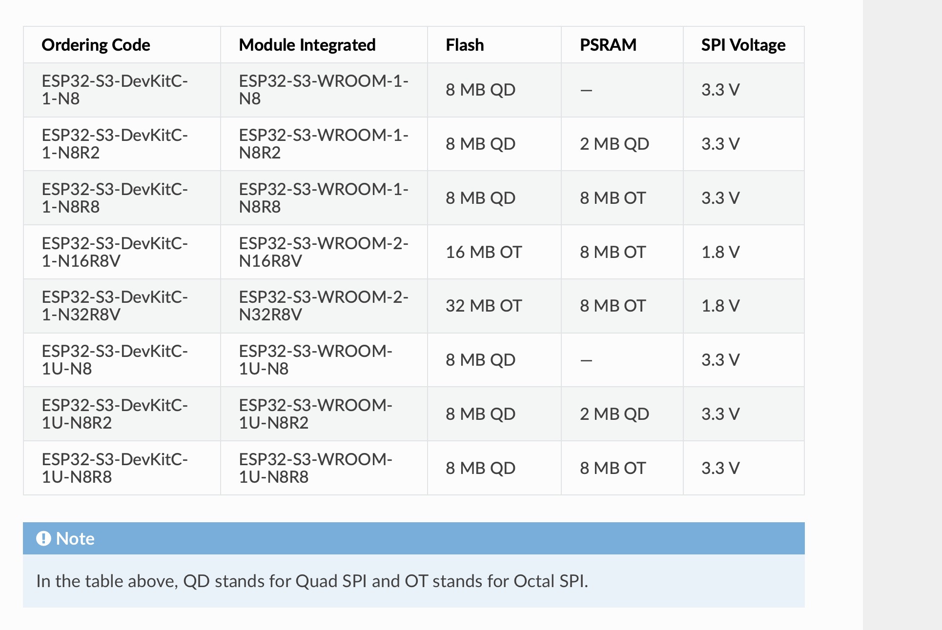

Hi, i'm having some trouble with Octal Flash on the ESP32-S3-DevKitC-1-N8R8.
I can compile and flash our project https://github.com/bwhitman/tulipcc/ with menuconfig option "Serial Flasher Config -> Enable Octal Flash" on, as it's presumably supported on this model.
But when running the app, I get "Octal Flash option selected, but EFUSE not configured"
I see this note
https://docs.espressif.com/projects/esp ... onfig.html
Which tells me to burn the EFUSE for the support. (I am confused as this is an Espressif board, and it says "Espressif guarantees this bit during module manufacturing", but I'll try anyway:)

But the app no longer boots with an error of
E (708) esp_image: Checksum failed. Calculated 0xf5 read 0x76
E (708) boot: Factory app partition is not bootable
E (709) boot: No bootable app partitions in the partition table
The application works fine on N32R8.
Does the EFUSE modify some checksum I should be aware of? Which checksum is failing? I've erased the flash and tried again, with the same error.

Are you absolutely 100% sure that devkit has octal flash? Because from what I can tell, it's supposed to have octal PSRAM but quad flash.

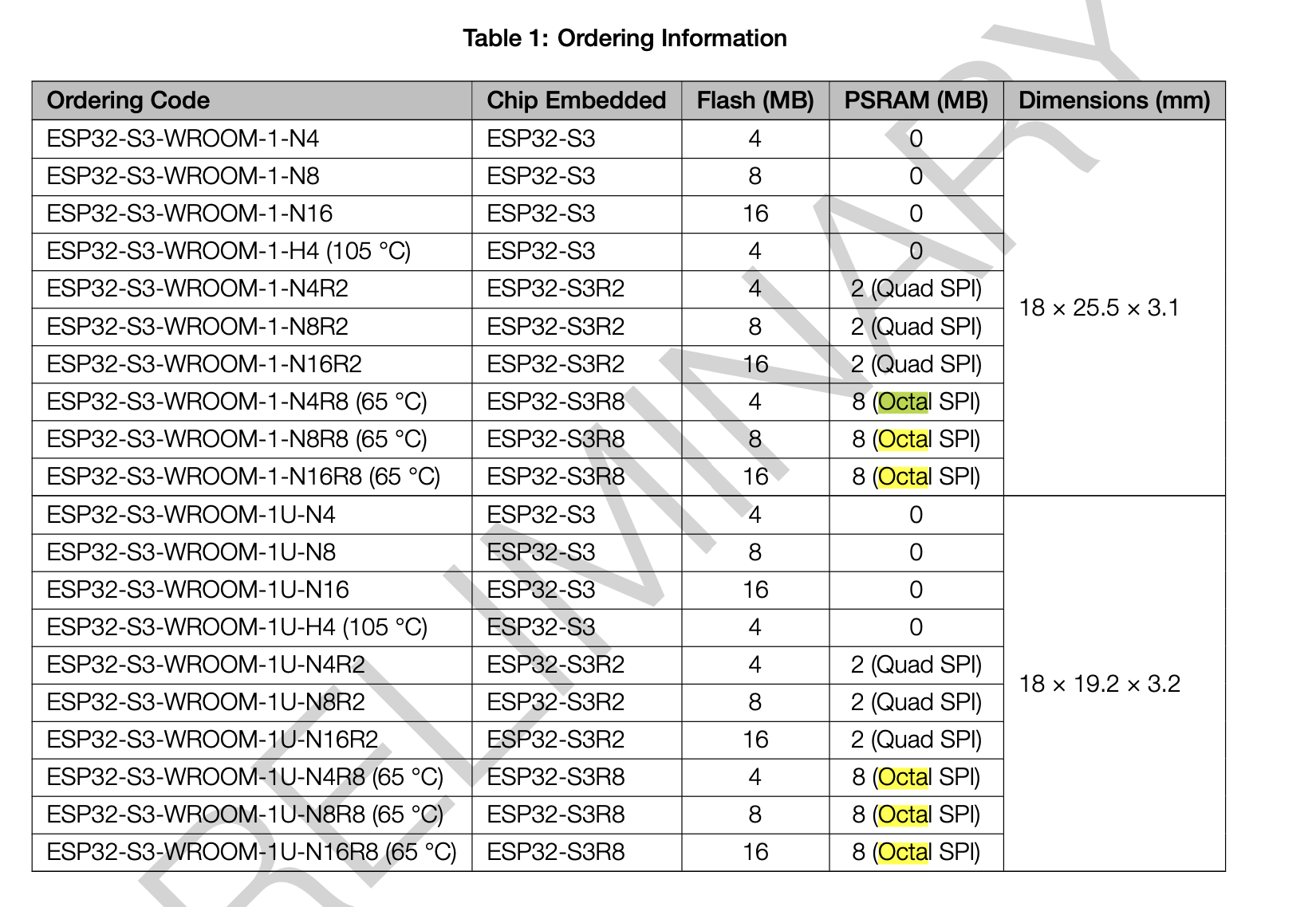

No, i guess i'm not! I was going by this chart, but on closer reading it's indicating octal SPI only for the RAM.

Do we know where to look to see which devkit / packages have octal flash support? I know the N32R8 does -- both the devkit and the module. Does the N16R8?

Ah, this page down a bit has a good table.
There are two variants of the N8R8. One has octal flash and one does not.
All N16R8s and N32R8s have octal flash.
https://docs.espressif.com/projects/esp ... itc-1.html
