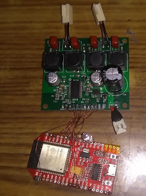

Re: I2S digital audio amplifier board for ESP32 Vroom need recommendation
I made my own TAS5753MD based board. According to the datasheet, PVDD minimum is 4.5V, but I've only tested it at > 7V ( 2S and 3S lipoly battery packs).
Unfortunately, I wasn't able to use TI's Purepath console software to do all the nice software enhancements like equalization, gain limiting etc. Because the console software will only generate register configuration files if connected to TIs purepath motherboard and the TAS5753 daughter eval board.
So I just have it up and running in default stereo mode with all options at default or disabled. Sounds pretty good, I have no idea how much better it could be if "tuned" correctly with PPC software.
If you're thinking of a product and are willing to purchase the PPC motherboard and evalboard, this might be an option
Bear in mind that the TAS5753MD requires MCLK, but if fs = 44.1kHz or 48khz, it works if BCK >= 64fs and MCLK is connected to BCK.
There was no direct way to set the clock speed in the i2s driver, so I modified BuddyCasino's internet radio streaming project configuration code to force 32bit instead of 16bit even though it's not a Merus board. That indirectly sets up BCK = 64fs instead of 32fs.
I can send you the eagle project files for the board if you like.
