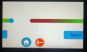

Hi everyone,
I have strange issue using LVGL and NVS library.
I use:
ESP-IDF 5.0
LVGL 8.3.0
FreeRTOS
Board:
ESP32-S3 WROOM 1
I have a some Screens in LVGL and everithing go well (Display and Touchscreen)
but in a Screen where i save a value in NVS, with the code below, the Screen shift a bit, and
everytime I call nvs_set_ all Screens of the GUI have horizontal shifting (like scroll), only rebooting they go back to the right position
Code: Untitled.c Select all
nvs_handle_t my_handle;
esp_err_t err;
err = nvs_open("storage", NVS_READWRITE, &my_handle);
err = nvs_set_u16(my_handle, "screen_lum", val);
ESP_LOGI(TAG," NVS err:%d",err);
nvs_commit(my_handle);
nvs_close(my_handle);
Screen shifted.png (107.62 KiB) Viewed 7077 times
No error returned.
I call the nvs_flash_init() on initialization phase, and reading from NVS with nvs_get_u16() doesn't cause any problems.
Anyone can give me suggestions?

Postby Sprite » Wed Apr 05, 2023 12:44 am
How do you initialize the screen?

Postby Sprite » Fri Apr 07, 2023 12:52 am
Looks like your framebuffer and DMA somehow get de-synced somehow. Can you try adding '.bounce_buffer_size_px=LCD_H_RES*8' to your panel_config and see if that helps?

Postby Ludos_vic » Tue Apr 11, 2023 6:52 pm
trying with .bouce_buffer_size_px = 8 * LCD_H_RES the screen drift vertical but more sporadically but your suggestion help my to find the right way...in fact it is a synchronization problem
I finally solved it with this combination:
.bounce_buffer_size_px = 20 * LCD_H_RES,
reduce the size of buffer in the PSRAM and don't use the second buffer
buf1 = heap_caps_malloc(LCD_H_RES * 100 * sizeof(lv_color_t), MALLOC_CAP_SPIRAM);
assert(buf1);
/*buf2 = heap_caps_malloc(LCD_H_RES * 100 * sizeof(lv_color_t), MALLOC_CAP_SPIRAM);
assert(buf2);*/
// initialize LVGL draw buffers
lv_disp_draw_buf_init(&disp_buf, buf1, buf2, LCD_H_RES * 100);
and this in sdkconfig
CONFIG_SPIRAM_FETCH_INSTRUCTIONS=y
CONFIG_SPIRAM_RODATA=y
CONFIG_LCD_RGB_RESTART_IN_VSYNC=y
The only problem is that when the screen goes out of sync and is re-synchronized due to CONFIG_LCD_RGB_RESTART_IN_VSYNC, the Screen have a little flash, but with this combination of settings the event is very sporadic, and I think it's an acceptable solution
this link also helped me
https://espressif-docs.readthedocs-host ... s/lcd.html
