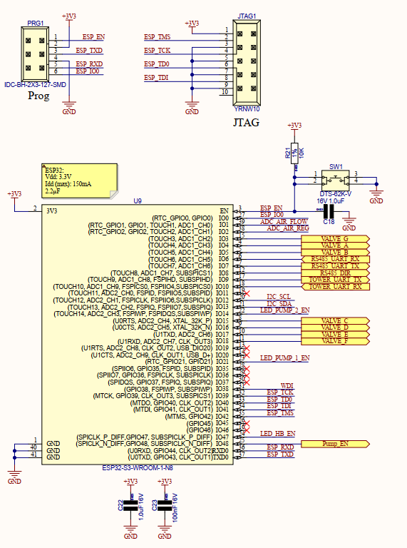

I'm trying to program the ESP32-S3-WROOM-1-N8, using Visual Code, Platform Io and the ESP-PROG. The following is my setup in platformio.ini:

I've followed the instructions to set up the drivers for the JTAG programmer, but I get the following error:

I then tried programming it using UART as we usually do, but this time with the ESP-PROG, before we alsways had the programming circuit on board and used a usb-serial converter.

I've checked that the connectors between my PCB and the PROG is correct.
This is the schematic for the ESP:
Screenshot 2023-04-19 144431.png (157.22 KiB) Viewed 1828 times
All of the GPIOs in use have 10k pull downs.
Any ideas on why the JTAG doesn't work, and why the program doesn't start after successfully uploading it.

The S3 by default has JTAG routed to its own internal USB-serial-JTAG adapter, you need to blow a fuse to have it accessible on GPIOs. Not sure why your program doesn't boot though.
