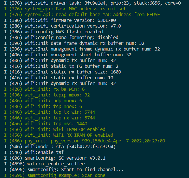

我使用vscode开发,idf版本是4.4.1,做的一个小项目上用到了smartconfig,当时使用的还不是C3,封装上写的是ESP-WROOM-32,一切正常,但我换成C3后,烧写同样的代码,smartconfig运行到“scan down”也就是扫描完成开始接收ESPtouch发送的网络连接信息的时候问题就出现了,手机端使用ESPtouch点确认发送,设备一点反应没有,代码里没找到问题就想着在跑跑例程看看,结果还是同样的问题,设备似乎接收不到UDP广播包,但换回ESP-WROOM-32就正常。 :?: 电脑上也试着抓了一下包,可以抓到UDP包。
串口输出大概如下:到scan done就停住了,用esptouch的app怎么点都没反应
I (386) wifi:wifi firmware version: 63017e0
I (386) wifi:wifi certification version: v7.0
I (386) wifi:config NVS flash: enabled
I (386) wifi:config nano formating: disabled
I (396) wifi:Init data frame dynamic rx buffer num: 32
I (396) wifi:Init management frame dynamic rx buffer num: 32
I (406) wifi:Init management short buffer num: 32
I (406) wifi:Init dynamic tx buffer num: 32
I (416) wifi:Init static tx FG buffer num: 2
I (416) wifi:Init static rx buffer size: 1600
I (416) wifi:Init static rx buffer num: 10
I (426) wifi:Init dynamic rx buffer num: 32
I (426) wifi_init: rx ba win: 6
I (436) wifi_init: tcpip mbox: 32
I (436) wifi_init: udp mbox: 6
I (436) wifi_init: tcp mbox: 6
I (446) wifi_init: tcp tx win: 5744
I (446) wifi_init: tcp rx win: 5744
I (456) wifi_init: tcp mss: 1440
I (456) wifi_init: WiFi IRAM OP enabled
I (456) wifi_init: WiFi RX IRAM OP enabled
I (466) phy_init: phy_version 909,156dee4,Apr  7 2022,20:27:09
I (546) wifi:mode : sta (34:b4:72:f3:c3:94)
I (546) wifi:enable tsf
I (606) smartconfig: SC version: V3.0.1
I (4696) wifi:ic_enable_sniffer
I (4696) smartconfig: Start to find channel...
I (4696) smartconfig_example: Scan done
