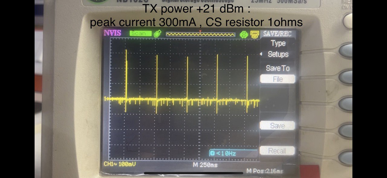

I am using the device esp32-c3-devkitc02 and the device radio current consumption is pretty high for the SOC (ESP32- C3) to run with Coin cell CR2032 ( 3V,220mAh , @max pulse current 10mA).

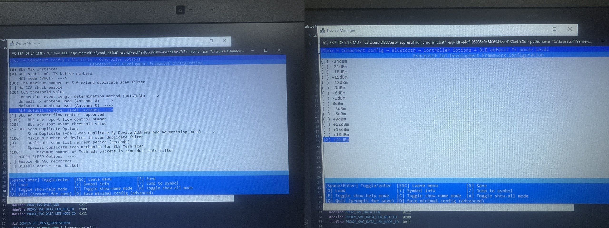

Is there an option to configure the device TX dBm level from +21 to -24bBm ?

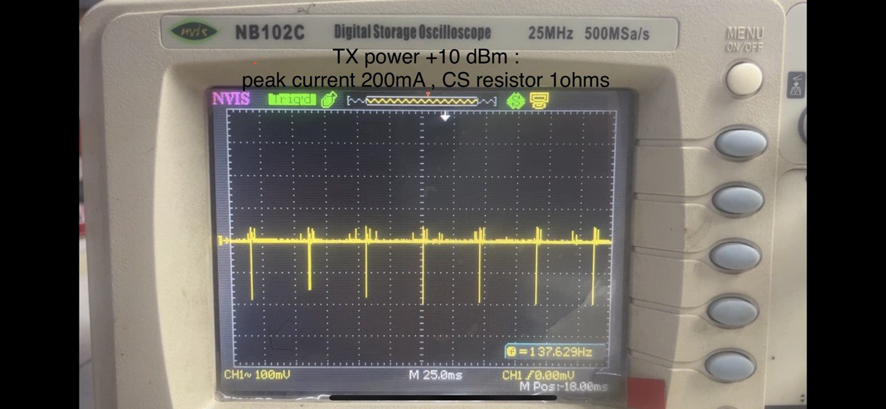

there was a significant current change as you can see form the images upon changing the TX power Level.
i have used 1ohm 3W shunt resistor for current measurement at the low side.
Peak Current of 300mA for +21 dBm
Peak Current of 200mA for +18 dBm (although the probes were connected correctly there was a -ve voltage displayed)

2) there was no option to configure the RX dBm level in the configurator
What would that kind of configuration be supposed to do? Defining the power of a received signal? Reduce the power consumption by lowering the sensitivity (gain) of the receiver?
