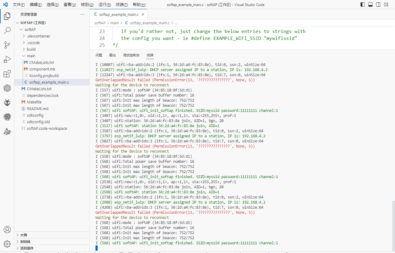

Postby guojiyuanzineng » Fri Apr 28, 2023 3:56 am
wifi_init_softap()函数有时一直初始化,请大佬帮忙看下

GetOverlappedResult failed (PermissionError(13, '???????????????', None, 5))
Waiting for the device to reconnect
I (557) wifi:mode : softAP (34:85:18:8f:5d:d1)
I (567) wifi:Total power save buffer number: 16
I (567) wifi:Init max length of beacon: 752/752
I (567) wifi softAP: wifi_init_softap finished. SSID:myssid password:11111111 channel:1
I (3407) wifi:new:<1,0>, old:<1,1>, ap:<1,1>, sta:<255,255>, prof:1
I (3407) wifi:station: 56:2d:a4:fc:83:8e join, AID=1, bgn, 20
I (3527) wifi softAP: station 56:2d:a4:fc:83:8e join, AID=1
I (3587) wifi:<ba-add>idx:2 (ifx:1, 56:2d:a4:fc:83:8e), tid:0, ssn:2, winSize:64
I (3797) esp_netif_lwip: DHCP server assigned IP to a station, IP is: 192.168.4.2
I (5027) wifi:<ba-add>idx:3 (ifx:1, 56:2d:a4:fc:83:8e), tid:7, ssn:0, winSize:64
I (558) wifi:mode : softAP (34:85:18:8f:5d:d1)
I (568) wifi:Total power save buffer number: 16
I (568) wifi:Init max length of beacon: 752/752
I (568) wifi softAP: wifi_init_softap finished. SSID:myssid password:11111111 channel:1
I (2538) wifi:new:<1,0>, old:<1,1>, ap:<1,1>, sta:<255,255>, prof:1
I (2548) wifi:station: 56:2d:a4:fc:83:8e join, AID=1, bgn, 20
I (2598) wifi softAP: station 56:2d:a4:fc:83:8e join, AID=1
I (2738) wifi:<ba-add>idx:2 (ifx:1, 56:2d:a4:fc:83:8e), tid:0, ssn:2, winSize:64
I (2988) esp_netif_lwip: DHCP server assigned IP to a station, IP is: 192.168.4.2
I (4268) wifi:<ba-add>idx:3 (ifx:1, 56:2d:a4:fc:83:8e), tid:7, ssn:0, winSize:64
I (568) wifi:mode : softAP (34:85:18:8f:5d:d1)

I have checked the example of https://github.com/espressif/esp-idf/tr ... ted/softAP, it can't reproduce your issue? Please share your code or modify information which can reproduce the issue.

The problem has been solved, and the reason was unstable power supply

我的是usb接口供电不稳,换了个插口就好了
