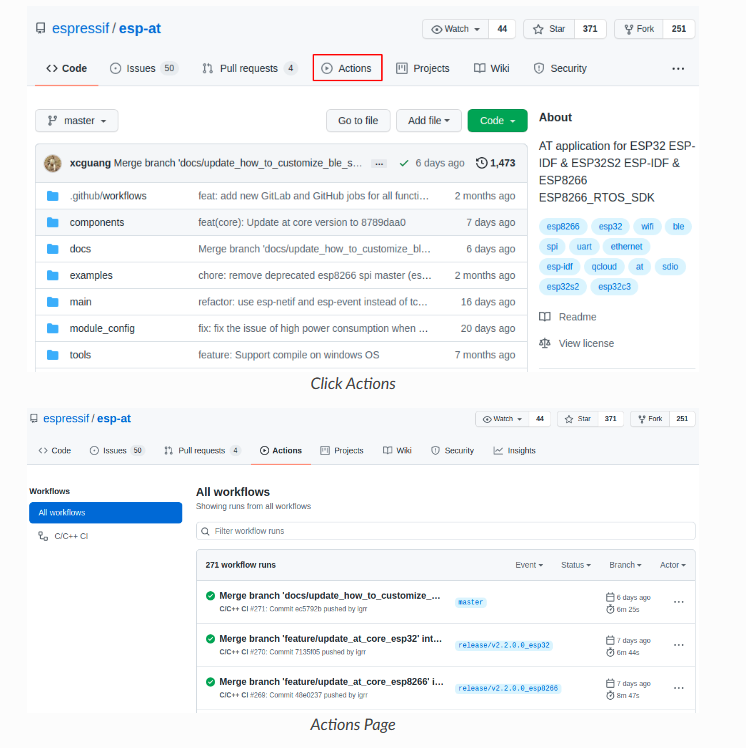

I followed the instructions in this doc:
https://docs.espressif.com/projects/esp ... _page.html
except for step 4 as I don't need OTA updates.
However - it says "After you complete the above steps, GitHub Actions will automatically trigger the compilation of your ESP-AT firmware." But it doesn't happen. Is there an extra step needed that's missing, or does this only work on non-free accounts maybe?

1. Are you compiling under the esp-at project under your own account warehouse.
2. You can see if there is your compiled firmware on the following page under the esp-at project in your warehouse

I followed the instruction in the espressif document exactly. so I forked the release/v2.2.0.0_esp8266 branch into my own account, as it shows to do.
The workflow page remains blank - "there are no workflow runs yet" and it only shows under my own account listing.
It looks the same as the ustccw example account in the document.
The instructions say it should compile automatically after a commit, but this doesn't happen. I assume there is perhaps a step missing in the instructions?
