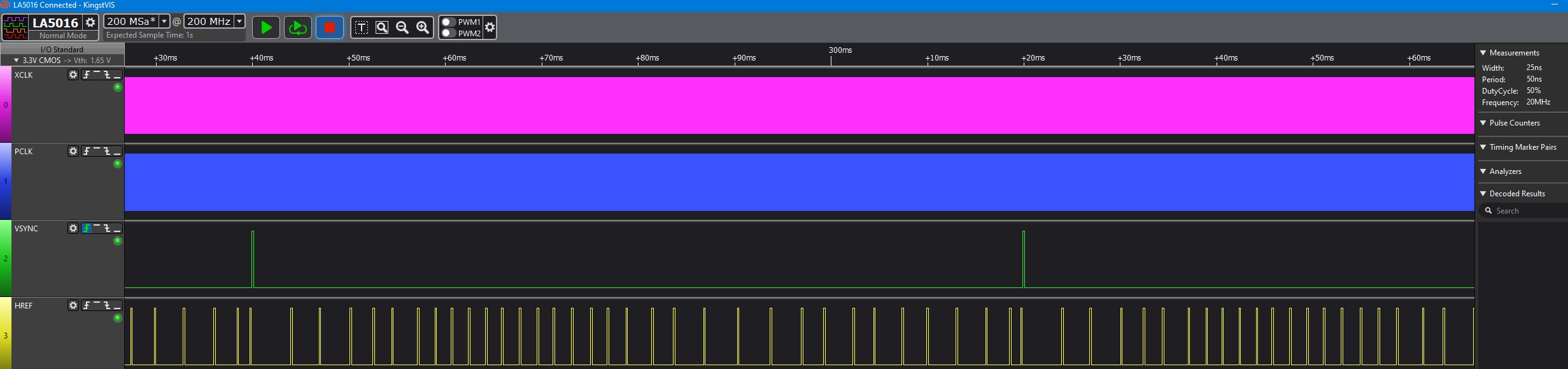

I am trying to integrate an OV5640 camera into an ESP32-S3 using GDMA and the LCD_CAM peripheral.
This is the first attempt and the objective is to verify that the peripheral captures the data from the camera interface and using GDMA writes it to the list buffer.
To check that everything works the DMA callback should be executed when the buffer is full and the content of desc.dw0.length should be 1470.
Neither of these two things happens, DMA callback is not executed and the desc.dw0.length content is 0.
Any help ?.

  // Here OV5640 camera configuration code using I2C
  // Camera interface is ok checked with a logic analyzer (xclk, pclk, vsync and href)
