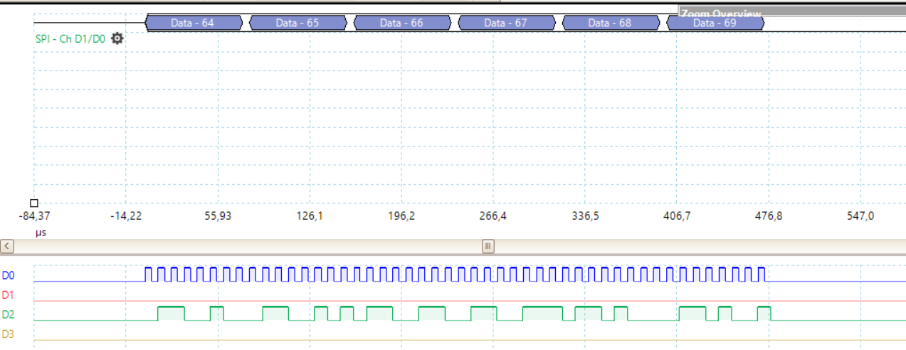

I'm trying to implement a custom SPI Bus-System.
I'm short on IO's, so I'm trying to have a virtual CS pin.
My idea is, clock is in high impedance normally.
Each sender has their own send Line / MISO / MOSI
One bususer, has the task to cyclically send a 1 byte token. This one Byte token is a address, either 1 or 2
The Bus with the address of the two, can afterwards send something.
I imagine this way, the message can have any length, while I don't know if thats the case for normal master-slave communication.
For now I'm just testing with fixed 6 Byte-transferlenghts.
I tried following:

Sadly I'm neither receiving something, nor the initial runthrough of
void SPI_com_slave_com_loop_RX(void)
    int n=0;
    esp_err_t ret;
    memset(sRecBuf, 0, _SPI_EX_BUF_SIZE*4 +1);
    static unsigned char do_once = 1;
    if((spi_ex_isInitialized[SPI2_HOST] == true)&&(spi_ex_trans_rx.rx_buffer!=NULL))
        if(do_once) // why do I need this?
            do_once = 0;
            ESP_ERROR_CHECK(spi_device_transmit(_spi_handles[SPI2_HOST] , &spi_ex_trans_rx));     // no additional & different than with spi_bus_add_device !
does also not send a clock or data.
The data sent to the module are ok as shown in attachment:

Postby MicroController » Mon Jun 05, 2023 4:48 pm
How about just using I2C? Takes only 2 lines total, is standardized, directly supported by hardware, and has already taken care of both addressing and transaction delimitation.
Accept86
Posts: 12
Joined: Fri Jun 02, 2023 9:07 am
Re: Implementing a custom SPI Bus-System handling for communication with another MCU
Postby Accept86 » Mon Jun 05, 2023 10:49 pm
Oh!
Thank you.
Really glad I asked
