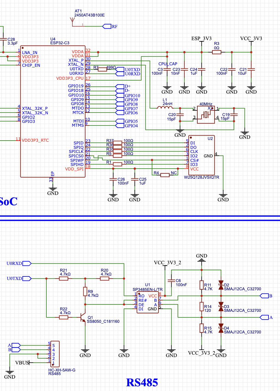

I designed a custom board to read an RS485 device using UART0 of the ESP32C3, GPIO 20 for RX, 21 for TX. I have now spent days trying to troublshoot it with no success. So any hints will be really really helpful
Here is my code and schematic.
Screenshot 2023-06-07 at 03.09.39.png (330.37 KiB) Viewed 3022 times
I couldn't manage to get any data out: Same schematic with SP3485 works fine with RPI PICO w based board. I tested them side by side.

Postby MicroController » Thu Jun 08, 2023 6:24 pm
The RS485 driver circuit looks... creative.
What's the voltage at pins DE/RE# when U0TXD is low? (SP3485's datasheet says it needs to be 2.0V min...)

Postby username » Fri Jun 09, 2023 3:50 am
Just a crazy question here. What is the point for all that circuitry for the TX pin to the RS485 ?
Why didn't you just route the TX to the DI pin?
Are you aware that ESP has a driver for RS485, in which you can simply supply the Tx, Rx & RE/DE pins?
