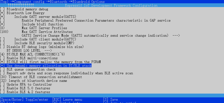

Postby dengbq » Thu Jun 08, 2023 11:13 am
硬件 :esp32-s3 krovo v3
idf V4.4.4+adf master
用到语音识别和blufi,启动时blufi时,把BT_INIT: Malloc failed
打印内容:

E (13073) BT_INIT: Malloc failed
E (13084) BT_HCI: CC evt: op=0x2008, status=0x7
I (13075) ESP32: BLUFI VERSION 0103

Postby dengbq » Fri Jun 09, 2023 4:27 am
屏幕截图 2023-06-09 101212.png (20.87 KiB) Viewed 6321 times
蓝牙这一块有问题,设置从优化从psram分配内存,动态分配内存,但根本不生效。
查看代码:
static void *malloc_internal_wrapper(size_t size)
void *p = heap_caps_malloc(size, MALLOC_CAP_DEFAULT|MALLOC_CAP_INTERNAL|MALLOC_CAP_DMA);
if(p == NULL) {
ESP_LOGE(BT_LOG_TAG, "Malloc failed");
return p;
写死了是用heap_caps_malloc来分配内存,代码有bug啊。
