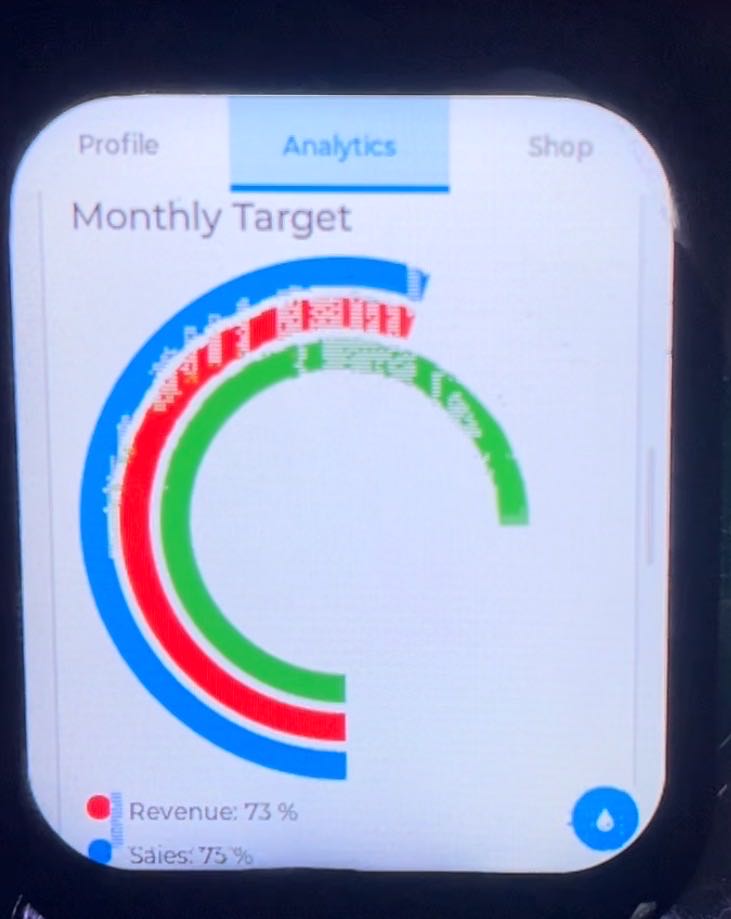

After using this example(SPD2010), I lit up the screen, but encountered the same problem as in the video(https://www.bilibili.com/video/BV1Lj411 ... da6a91f2ad), which has incorrect pixels when only refreshing the arc.Other shapes were normal.
i have test it on gc9b71 and SPD2010(as you have mentiented), all are exactly the same error.
i use gc9b71 example in https://github.com/DoctorTag/esp32S3_watch
I strongly suspect that this may be a bug in lvgl(no matter 8.0~8.3)
圆弧出现花屏

Sorry, I can't see the specific reason right now either.
However, the probability of LVGL having a bug is relatively low, as we've successfully run this demo on other screens.
In the next two weeks, I'll attempt to drive the SPD2010 and GC9B71 displays to see if the same issue arises.

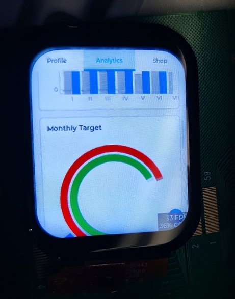

Good news, I successfully drive the GC9B71 QSPI LCD. The demo project is as below. Please carefully read the "README.md" and configure ESP-IDF as required.
GC9B71_QSPI_1_89_320_386.zip
(33.11 KiB) Downloaded 932 times

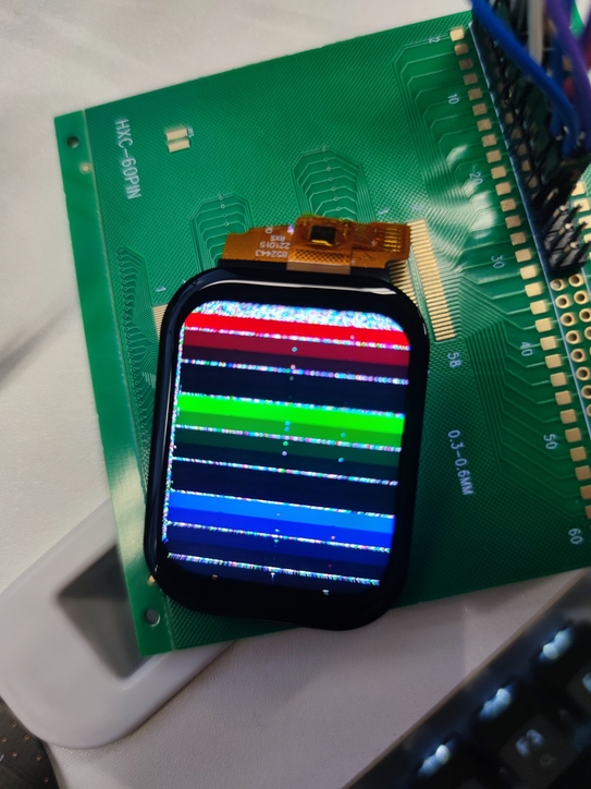

And I also have the same problem as below before. This situation occurs when I draw color bars every 2N+1 (N is an integer) rows or columns, but when I refresh every 2N (N is an integer) rows or columns, the display appears normal.
So I use the below code to round the start coordinate into 2N, and round the end coordinate into 2M+1. Then register it into LVGL by rounder_cb of lv_disp_drv_t.
void lvgl_port_rounder_callback(struct _lv_disp_drv_t * disp_drv, lv_area_t * area)
    uint16_t x1 = area->x1;
    uint16_t x2 = area->x2;
    uint16_t y1 = area->y1;
    uint16_t y2 = area->y2;
    // round the start of area down to the nearest even number
    area->x1 = x1 > 0 ? (((x1 - 1) >> 1) << 1) : 0;
    area->y1 = y1 > 0 ? (((y1 - 1) >> 1) << 1) : 0;
    // round the end of area up to the nearest odd number
    area->x2 = ((x2 >> 1) << 1) + 1;
    area->y2 = ((y2 >> 1) << 1) + 1;

Code runs perfectly!
