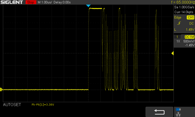

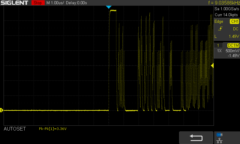

  • I probed RXD[1] and TXD[0] pins while sending bidirectional traffic. Unfortunately, my personal scope setup is somewhat modest and I don't have a differential probe so, really, all I am looking for is structure in the data. And structure I do find, see attached waveforms. Given this, I am fairly certain that RMII is functioning as expected.

The one thing that I have not yet been prove or disprove is if the ESP MAC is actually receiving the data from the PHY. I know the PHY is jiggling the RXD[1:0] lines but maybe the internal MAC FIFO is rejecting the data due to clock skew or something like that? Do you know of any way to answer this question on the ESP side?

Well, I found the issue: there was a cracked solder joint under the RXD0 pin on the ESP. Infuriatingly, I was probing RXD1 which is why we didn't see anything untoward in the waveforms I posted. Reworking this and the surrounding connections now has RMII functioning as expected. How embarrassing. :oops:
