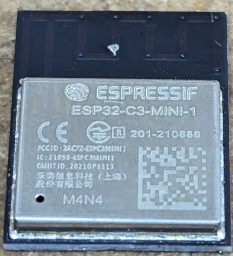

Attached I have pictures of the "New" chip from mouser and the "Old" chip that was pick and placed

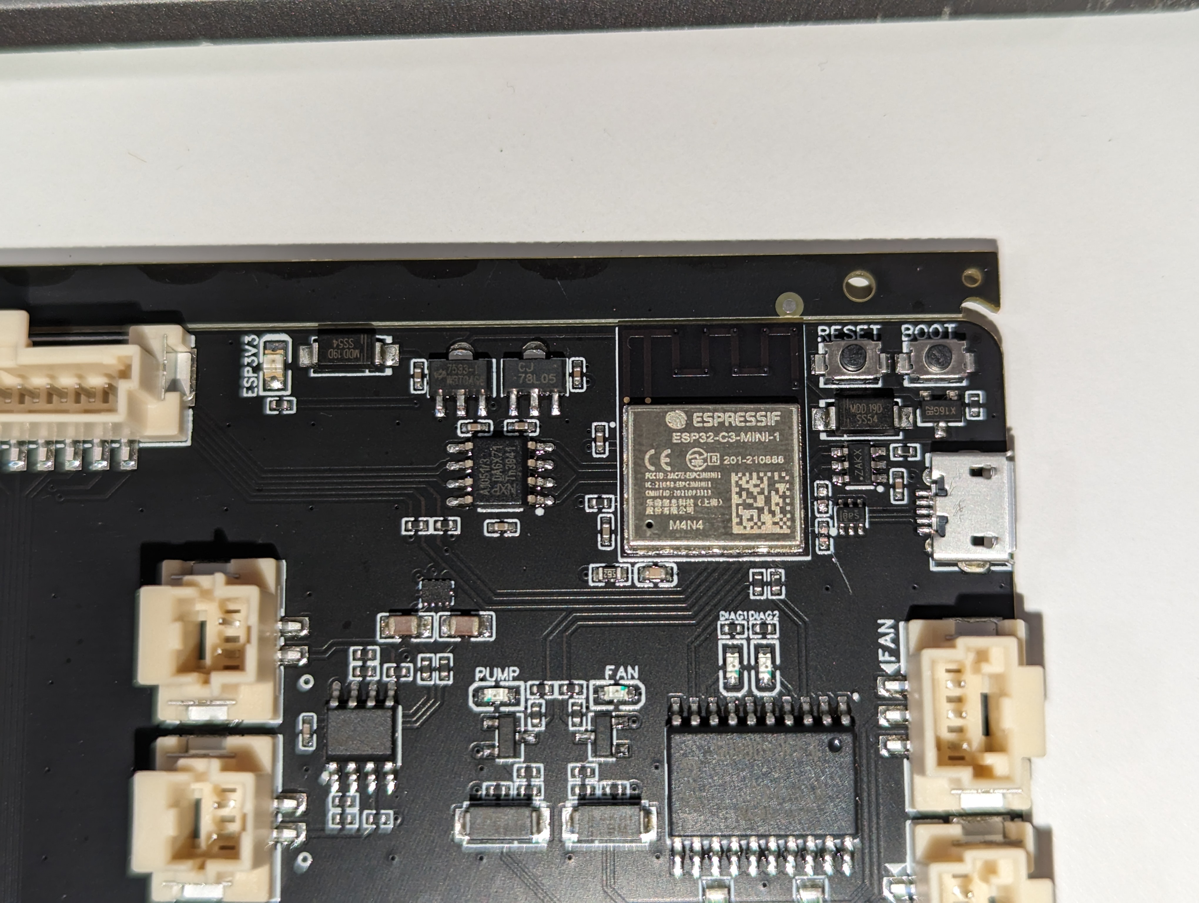

- Faulty Micro
- PXL_20230717_044321932.jpg (167.45 KiB) Viewed 6992 times
- Before Microcontroller Replacement.jpg (2.09 MiB) Viewed 6992 times

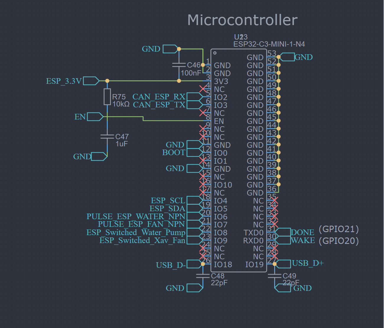

If anything, your schematic is faulty; BOOT on the ESP32C3 is GPIO9, not GPIO0. Can you force that low on one of the 'broken' boards on powerup/reset and see if you can program them then? Additionally, you probably want to have GPIO2 and GPIO8 to be high on bootup, see the 'strapping' section of the datasheet for more information. (Generally, if you design a PCB, please make sure to properly read the datasheet and the relevant sections of the hardware design guidelines, that will help you to get your board running the first time)

The boot pin is definitely in the wrong location however I have experimented a significant amount with getting the actual boot pin (9) low to get into bootloader mode
It does show up as a different device on device manager (I think) however it will not take a flash.
There is another PCB we made that has the boot pin in the correct location but still no joy (Actually that was the first batch of unflashable parts)

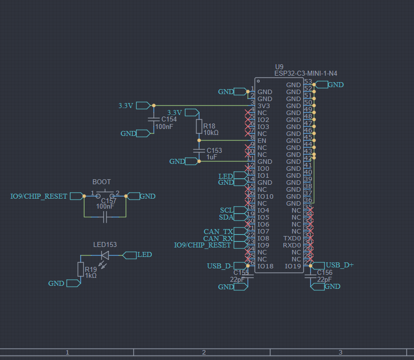

Re: ESP32-C3 from LCSC faulty?
That was a mistake on my part with that board however I have attempted to put it in bootloader mode using IO9
This did not fix the issue, although it did behave differently in device manager
Another board (attached schematic) also has the same issues
I am certain there is some form of hardware issue on the micro that is not related to the PCB as swapping the microcontroller worked fine.

With some PCBs we left the boot button off as we never had to use it, even for first flash

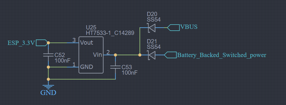

And the additional thing I mentioned of having GPIO2 and 8 high on bootup? Also, what's your 3.3V power supply like, as in how is it generated?
I have measured GPIO 2 and found it to be low (but it may come to bite us later if the microcontroller boots during CANRX)
GPIO 8 is an output with a 10k pull down
The power supply is a simple LDO

That LDO is far from enough to drive an ESP32-C3: the datasheet says "If you use a single power supply, the recommended output current is 500 mA or more." and yours can only provide 100mA. It's pretty likely your ESP32 is browning out.

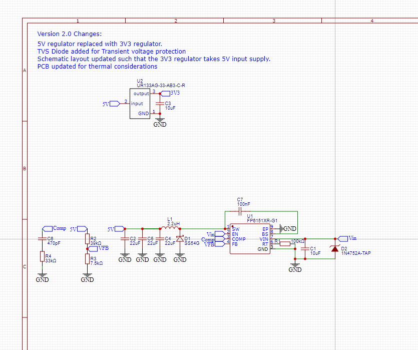

Running the device from a bench top power supply still yeilds no fix
I have since bodged in an alternative power supply as attached below
Scoping 3v3 shows no issues
As I said in an earlier post, replacing the microcontroller fixed the issue
We still have 4x boards that have not powered up as yet and will have the same dead microcontroller issue
Replacing the micro with one from stock (mouser) does repair the board
