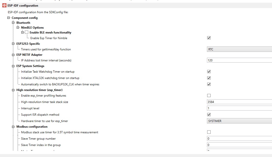

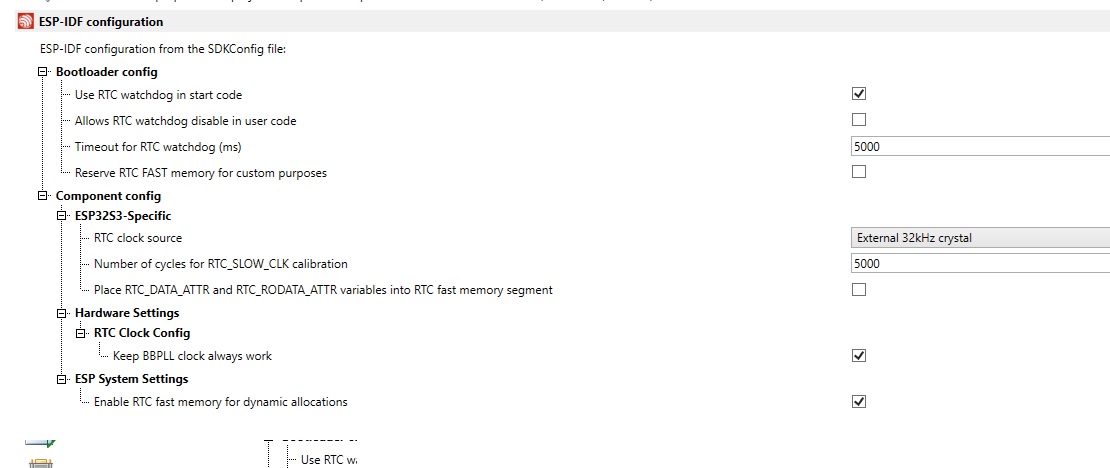

I am using the ESP32-S3 (ESP32-S3-WROOM-1U-N4R2), and we need an accurate RTC.
At the hardware I have connected a 32.378Hz crystal clock at pin 8 (IO15) and pin 9 (IO16).
We use the ABS07-32.768KHZ-T crystal and have load capacitors of 15pF.
The problem is that the clock is very inaccurate. We expect about 20ppm, but we measure about 850ppm difference.
Changing the stray capacitance does not make any difference. We tried 6.8pF instead of the 15pF, but still the same difference...

Visual GDB:
- IDF version: 4.4.2
- See attachments

Hello All,
I have found a problem which causes the deviation of the RTC clock.
It seems be be in software somewhere.
When I use the rtc_time_get() function the clock is accurate.
When I use the gettimeofday() function the clock deviation is about 700ppm.
The gettimeofday() is inaccurate both when I set calibration time to 0 or 5000.
So maybe someone can tell me why this difference occures in software??
