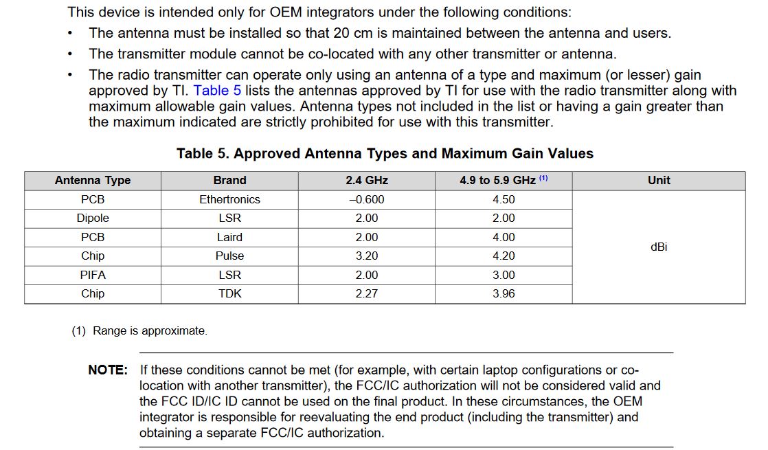

I'm planning on using the ESP32-WROOM-32UE module in a shipping product and plan to leverage the wireless pre-certification status of the module. Typically, this comes with restrictions on which antennas can be used in order to maintain the validity of the pre-certification.
For example here is a table of information for a specific TI wireless module. They do not identify specific part numbers, but many suppliers do go as far as listing exact part numbers:

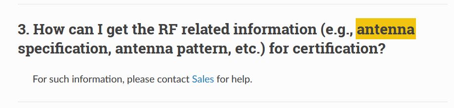

I can't find any such approved antennas list in any of the ESP32-WROOM-32UE documentation on the site.
The only mention I can find is in the technical FAQ:
faq antenna.JPG (34.29 KiB) Viewed 50881 times
I have contacted Espressif for this information but have not received a response. Does anyone have any information about these?

We only measure the gain of PCB antennas and do not measure that of external antennas. Generally, we recommend the maximum gain of external antennas should be smaller than 2.33 dBi.
