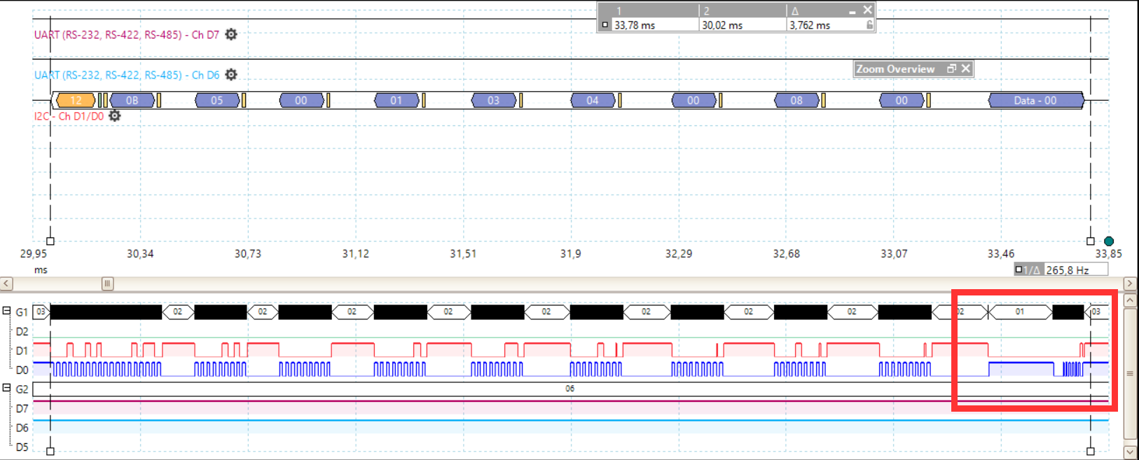

Im trying to stream bus data from another microcontroller to the esp32 per I2C.
The ESP32 is the I2C master.
Problem is, there appear delays in longer telegrams in the I2C stream, the esp32 seems to have issues with it.
2023-07-20 20_51_25-PicoScope 6.png (92.7 KiB) Viewed 1687 times
Im not exactly sure why that is, but the issue seems to be on ESP32 side. Maybe Interrupt priority issues? I didnt manage to force the i2c to use an higher priority yet. My tasks mainly use Task priority 1 and 2.

The function returns at the second error check...

The IDF I2C driver gets really inefficient when you use i2c_master_read_byte or i2c_master_write_byte, handling one interrupt after every byte sent/received; use i2c_master_read and i2c_master_write to transfer as many bytes in one go/interrupt as possible.
Instead of
        i2c_master_write_byte(cmd, (IO_EXP_BOARD_ADDR << 1) | WRITE_BIT, ACK_CHECK_EN);
        i2c_master_write_byte(cmd, i2c_writecount_or_read, ACK_CHECK_EN);
        i2c_master_write_byte(cmd, i2c_reg, ACK_CHECK_EN);
        i2c_master_write_byte(cmd, i2c_writecount_buffer_response, ACK_CHECK_EN);
you could do
const uint8_t data[4] = {(IO_EXP_BOARD_ADDR << 1) | WRITE_BIT, i2c_writecount_or_read, i2c_reg, i2c_writecount_buffer_response};
i2c_master_write(cmd, data, sizeof(data), ACK_CHECK_EN);
Same for reading. (Where you can also use i2c_ack_type_t::I2C_MASTER_LAST_NACK for convenience.)
