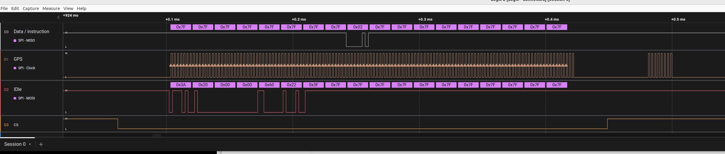

I'm "porting" pipeline_recording_to_sdcard example to an aliexpress board YD-ESP32-23 2022-V1.3.
It is equiped with ESP32-S3-WROOM-1. I connected this kind of sd card adapter:
https://fr.aliexpress.com/item/10050052 ... pt=glo2fra
Yet, nothing else is plugged on the board.
I changed this line :
    audio_board_sdcard_init(set, SD_MODE_1_LINE);
to :
    audio_board_sdcard_init(set, SD_MODE_SPI);
I created a custom board with this definition for SD SPI:
#define SDCARD_INTR_GPIO          GPIO_NUM_45     /* You need to define the GPIO pins of your board */
#define SDCARD_OPEN_FILE_NUM_MAX  5
#define BOARD_PA_GAIN             (10) /* Power amplifier gain defined by board (dB) */
#define SDCARD_PWR_CTRL             -1
#define ESP_SD_PIN_CLK              GPIO_NUM_12
#define ESP_SD_PIN_CMD              GPIO_NUM_16
#define ESP_SD_PIN_D0               GPIO_NUM_17
#define ESP_SD_PIN_D1               -1
#define ESP_SD_PIN_D2               -1
#define ESP_SD_PIN_D3               GPIO_NUM_15
#define ESP_SD_PIN_D4               -1
#define ESP_SD_PIN_D5               -1
#define ESP_SD_PIN_D6               -1
#define ESP_SD_PIN_D7               -1
#define ESP_SD_PIN_CD               -1
#define ESP_SD_PIN_WP               -1
The SD card initialization failed. Here's the log, it shows that sdmmc_init_ocr fails:

I'm using IO 12 16 17 15 . i plugged a logic analyzer on SD card pins, and things seem to be correctly
configured (See screenshot), also I observe some clock signal when CS is off.
What can it be?
Thanks
Julien

I also tried with the /esp-idf/examples/storage/sd_card/sdspi/ example and I get the same result.
