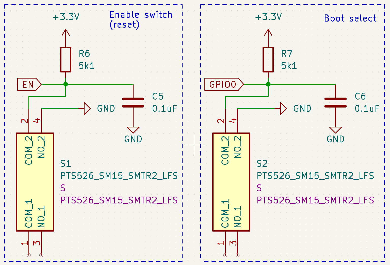

This is the part where I start to doubt myself sometimes. I've included a screenshot of my reset and boot select switch. I also used this on the ESP32-C3 board that I made earlier and it worked there, although of course with a different boot select pin. What I am currently doing to get into download mode is hold the boot select button, a short press on the EN button to restart the MCU and then let go of the boot button. From what I have gathered that is how you are supposed to get the ESP32-S3 into download mode. I am hoping that I am actually doing something wrong here, because that would be easy to fix.

No, that should work. Given you still have the UART connected, what does it say when you try to boot into download mode? (Also, you may want to remove C6, if everything works it makes your device always come up in download mode, which you generally don't want.)

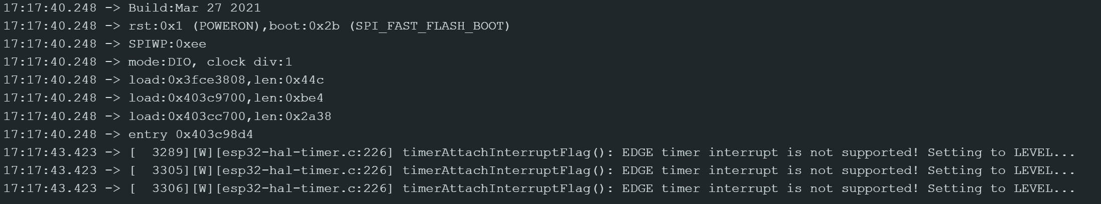

That's the thing, UART does not work. I've used it before to program other microcontrollers and I know that the FTDI chip works, but for some reason the ESP32 isn't responding or sending any data. Sometimes when I have it connected via USB, I am lucky and the arduino IDE shows the startup message with the (what I assume is) chip build date and some other info, I don't completely remember what it says. This is done before the firmware I uploaded starts doing its thing, after that the USB data negative pin goes to 1V.

Correction to my last post (which hopefully gets approved before this one so it makes sense). UART does it fact work, but I still can't upload an new (empty) sketch, even when I try putting it into download mode(I also removed the C6 cap). Below is a picture of what the ESP spews out before it starts running my faulty program. Although I haven't seen the last bit before.
